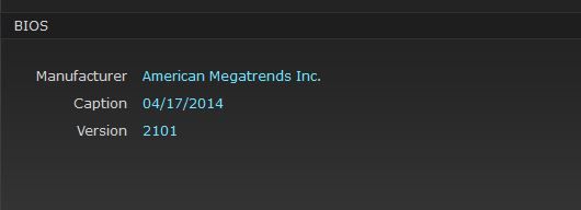

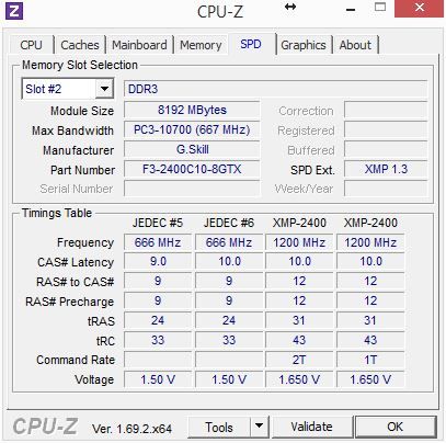

Here are the additional screenshots. The stepping on the CPU is actually fluctuating, I just happened to catch it on the low side in that screen shot. Here is the CPU again, but on the higher stepping, and both the memory tab, and the SPD tab with one of my memory slots showing.
381323813338134
I honestly have no intentions on ever attempting to over clock this system, being as it's already significantly faster than what I had before (i5 quad 2.4Ghz). I just need it stable enough to do my work on it, and to run a virtual machine or two while still working in the host.
And just for the sake of clarity, the UEFI/BIOS is currently set to all defaults, and is updated to 210138135

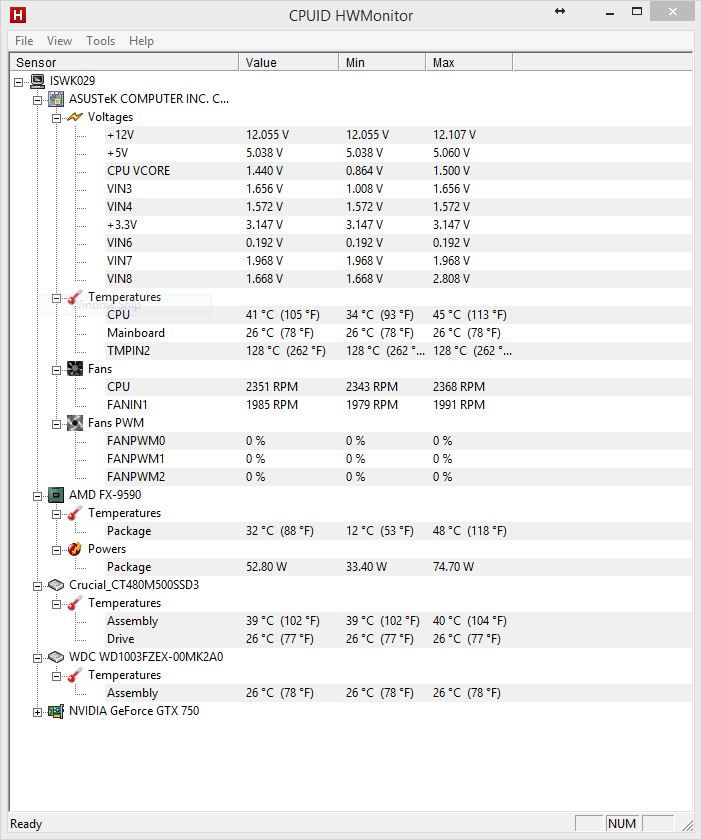

Right now the BIOS is running on defaults, I'm gonna let HWMonitor run for about an hour, then post a screenshot. After that I'll go in and configure the memory to where it is supposed to be, and then post CPUZ screenshots again.

Here is HWMonitor after about 40min. 38141

Clearly your temps are now stabilised at defaults.
Now run ROG Realbench stress test for 10 minutes with HWmonitor in the back ground and compare the min and max temps
