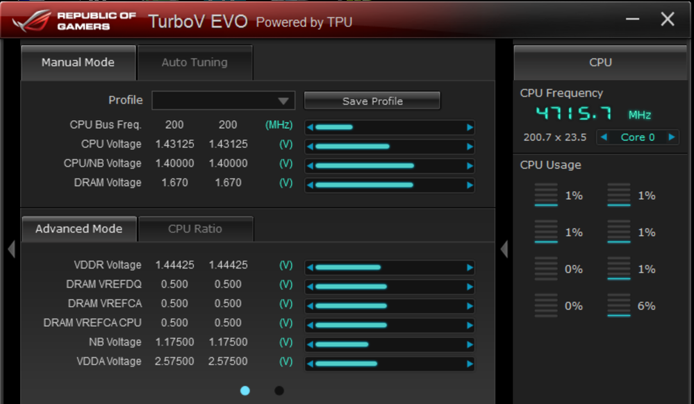

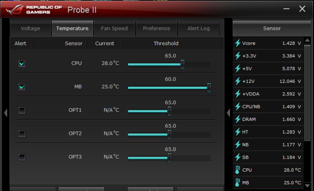

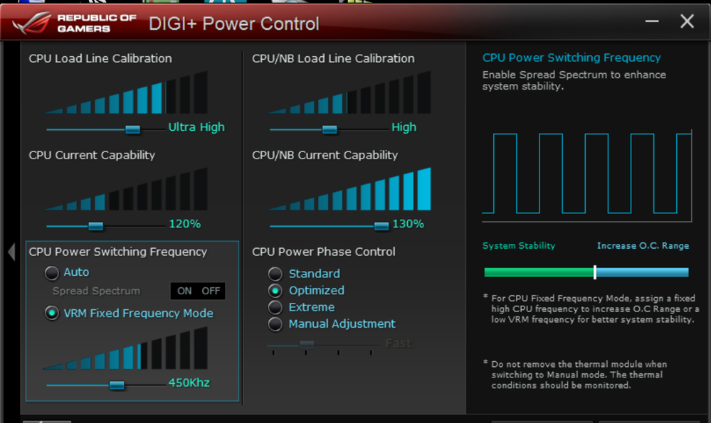

Here are some desktop screens of my voltages, but remember, no two boards are the same, no two CPU's, set's of memory, PLUS, this system has a
Fair water cooling system on it, so CPU voltages should be handled carefully, and DO NOT unlock Extreme Over Volting when the CPU voltage is set to
manual. Set memory voltage (if memory is set to stock speed and SPD's) to the correct voltage + 1 increment above for stability. Also set the VDDA
1 step up for the same reason.
Remember, the settings I'm suggesting you start with should be "STOCK" on everything, until you have your OS installed and updated completely.
From where you are according to the picture of your bios, nothing has been set up yet, so if I've wasted your time with this info, I apologize.
Here are my desktop screens that will give you an idea of "my" settings, so that you can get a basic idea of what to look for, and how to get started..;
just don't try it at that speed unless you have some decent water cooling at minimum, and I advice against attempting to install the OS at speeds such
as what I am running, as it can cause problems, and possibly not be able to set up the OS at all. Also, don't hang out in the bios too
if you don't have good cooling...CPU is active and running about 5-10%, so it does build up heat.
