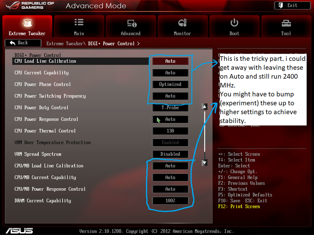

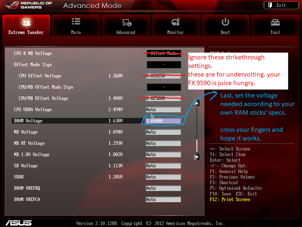

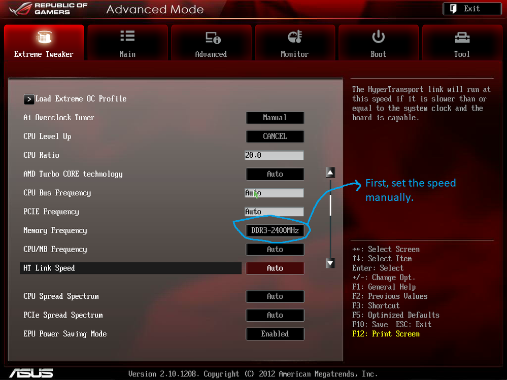

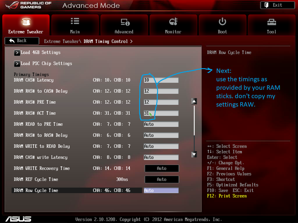

also, running your sticks on D.O.C.P is the lazy method, i'd highly recommend you to set these up manually. i can't say much for your ram sticks, but take my ram sticks for example; these settings are worth a try (though not guaranteed to work):
- Bios 2201. i entered each settings manually.
- mine are on slot #2, slot #4 (slot #1 and #3 wasn't stable for mine). yours is a 32 GB kit, i assume 4 sticks @ 8 GB each?

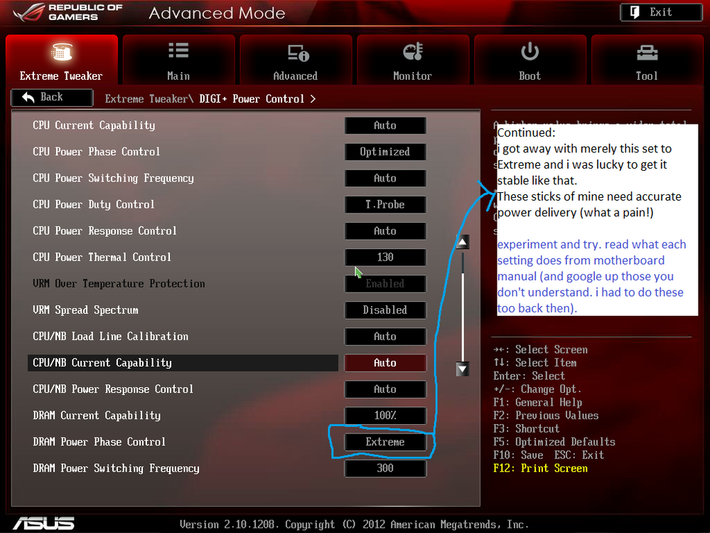

- i had to push LLC and what's that other setting(?) to extreme preset to get it stable. i'll get you screenshot as followup post.
- save and exit
cross your fingers and hope it runs well. verify stability with stresstest and memtest AND sleep/resume from sleep test.
if all of the above fails, i guess you should manage your expectations and just run them at @2133, since the performance gain is negligible (to be honest).

Got some screenshots for you:
67875
67876
67877
67878
67879
i forgot stuff: D.O.C.P is AMD's way of making XMP profiles work. my sticks were originally made for X87 chipsets. i find manually entering the ram settings help with stability. your experiences may differ.
