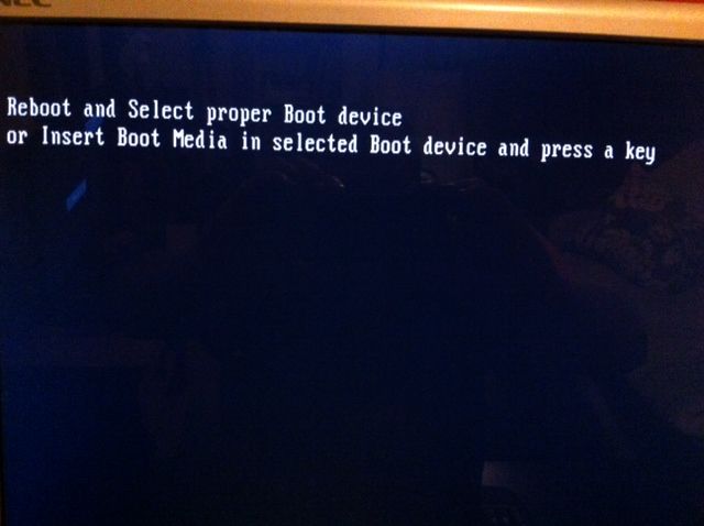

after updating from 12xx to CAP BIOS (with converter via UPdate from AI SUITE) I can't boot as usual.
Every restart throws: "reboot and select proper boot device or insert boot media in selected boot device and press a key",

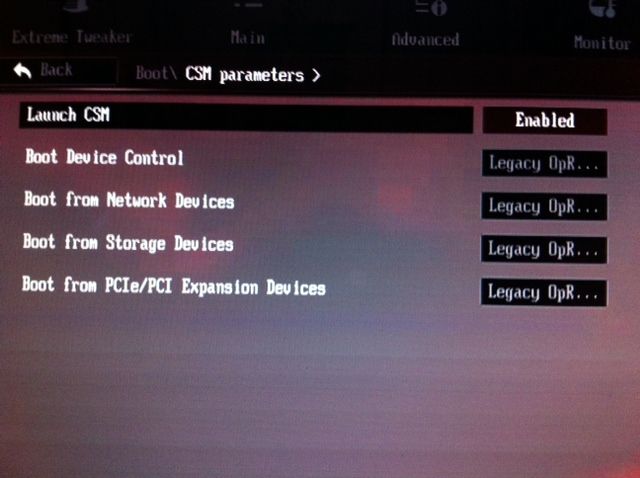

after reboot, doing DEL>BIOS>Boot>CSM Paramters (nothing Changed) > F10 Save and rebboot it boots from my SSD drive, but on next restart it is same over again, message, enter bios > hit F10 Save reboot.

Now on that menu in the UEFI that is shown in your second screenshot there more options below the Security Boot Parameters and you have to scroll down to see them. The boot order should be there. Let me know what options you can see there. Does it have a "Windows Boot Manager" option? Or does it simply list your drives? If there is a "Windows Boot Manager" option set that one as default and try booting.
