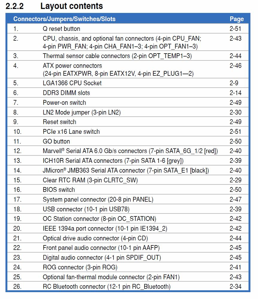

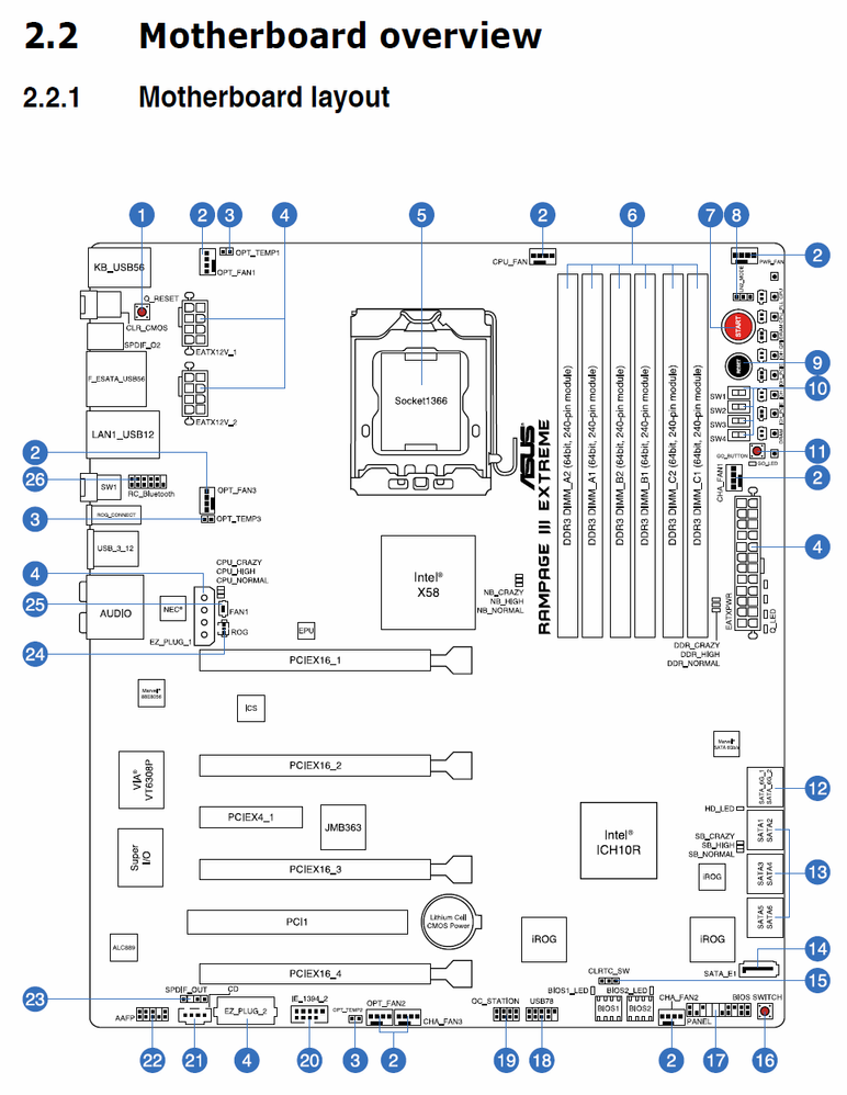

You could try re flashing your bios to see if it is corrupted, your SSD should be connected to the Intel SATA port for best performance and set to AHCI before OS installation, you cannot change after the OS is installed. Intel IRST drivers are not needed unless you are using a Raid array, Intel chipset drivers are needed
Intel SATA ports = (13)
