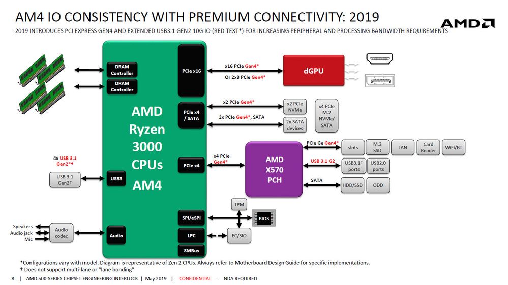

Here is how your board pcie lanes work:-
In General:-
82929

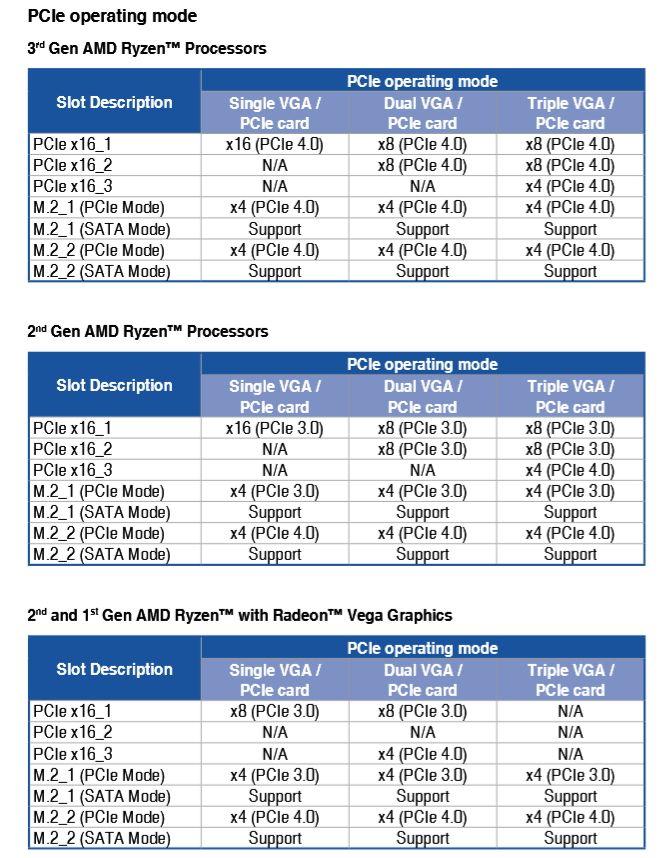

CH8 Specification (source: the manual):-
82930
short answer no problem - till you running three gpu's and second m2 from what I read.
One thing interesting, off topic, the mix of Gen 3.0 and Gen 4.0 on Ryzen 2000 series on this board, specifically 16_3 x4 Gen 4 ? typo? I think should be Gen 3 like the other two. And you would be better using the Second m2 as your primary if you had gen x4.0 device.
