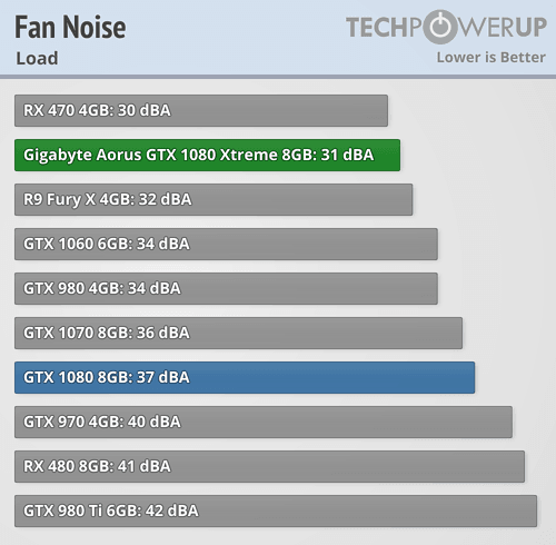

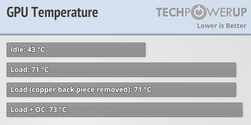

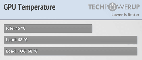

Chino
Level 15
Actually, the Strix GTX 1080 runs cooler than the Gigabyte card. Maybe you're getting high temperatures because the airflow inside your case is deficient. Do remember that you're running a SLI configuration which requires good airflow to keep the both graphics card as cool a possible.
Strix GTX 1080
62523
Gigabyte GTX 1080 Aorus Xtreme Edition
62524

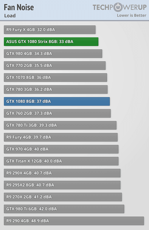

Regarding noise, the Strix is only 2 dBA louder which should not be noticeable in real life usage. Whether the fans spin faster or slower depends on your ambient temperature and once again, the airflow inside your case.
Strix GTX 1080
62525
62526
