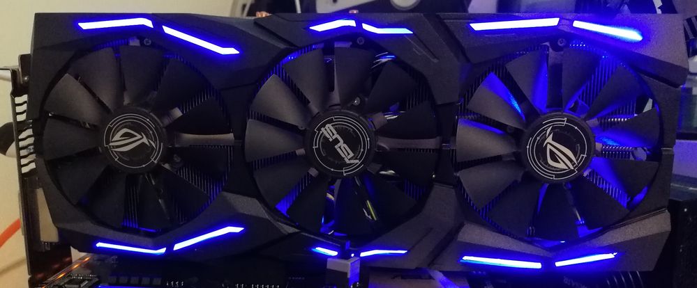

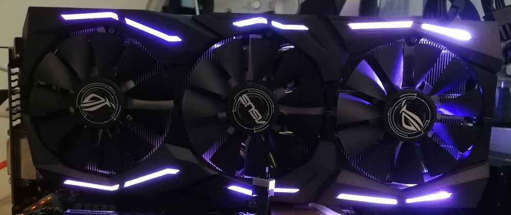

So I've had my Asus Strix OC GTX1070 since November of 2016. All of the RGB LED's worked perfectly fine when I got the card, and I've had no issues otherwise with the performance of the card. However, I noticed yesterday that the RGB LEDs seemed to only be partially functioning on one end of the card. Here are some pictures: The first picture is what the card looked like after installing it (properly functioning RGB LEDs), and the second picture is what it looks like now (RGB LEDs only working on one side.
71549
71550
Anybody have an idea of what I could do to fix this? I tried reinstalling/updating the Asus AURA program, GPUTweak, and GPU BIOS, all to no avail. The card performs perfectly fine, no overheating/fan issues, no performance loss in games, etc.
I just want to know if there is some simple fix that I'm completely missing, or if there is no way to fix this. Any help or suggestions are appreciated.

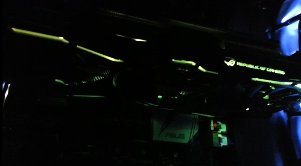

Here you se my card with original optic cable (lights set blue):

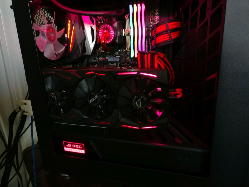

Here the replacement was built in (lights set blue):
75191
It is not 100% working, because when the light is set to white it turns a little purple in the end of the fibre but I am lucky with the result.
EDIT: Here you see the card with white lights:
75192
The lights are looking even more purple on the pictures made with my phone 😄
waintdeir wrote:

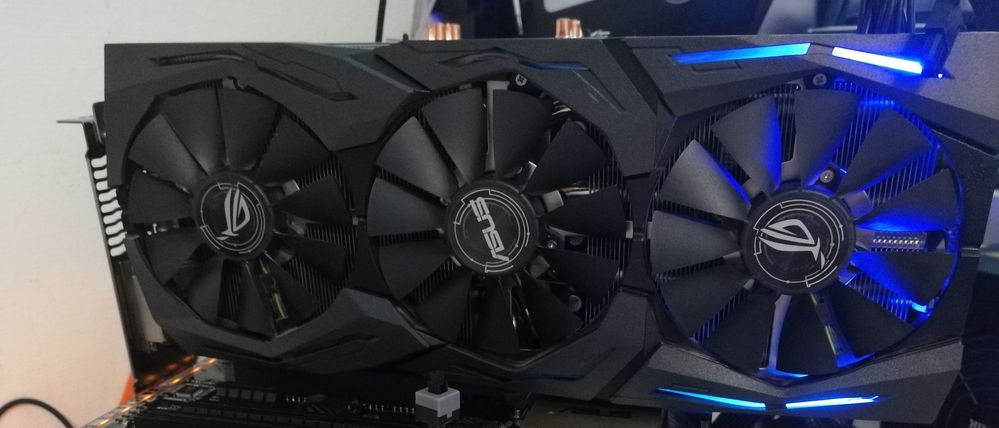

I had the same issue with an Asus ROG Strix 1080ti and ended up buying a 1M long 4mm light tube from eBay for $5. It took 4 weeks to get here but the repair took 5 minutes. Here are the before and after with a picture of the light tube I bought.
The picture with the fan shroud dissembled shows the old tubes that have turned milky white on the right. The actual LEDs are the 2 at the top of the picture.
