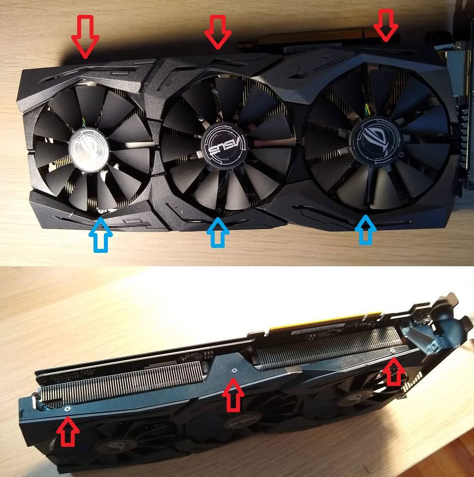

1. Remove the plastic shroud by unscrewing the 6 screws shown in the pic below (Three screws with red arrows and three with blue arrows)

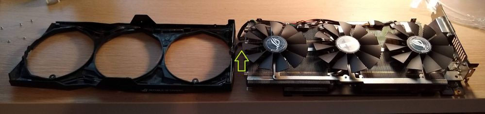

2. Carefully remove the plastic cooler shroud in a clam shell fashion like in the pic below and disconnect the RGB cable noted by the green arrow. Be careful with your fans, the shroud has little "tabs" that stick out and can potentially break a fan blade.

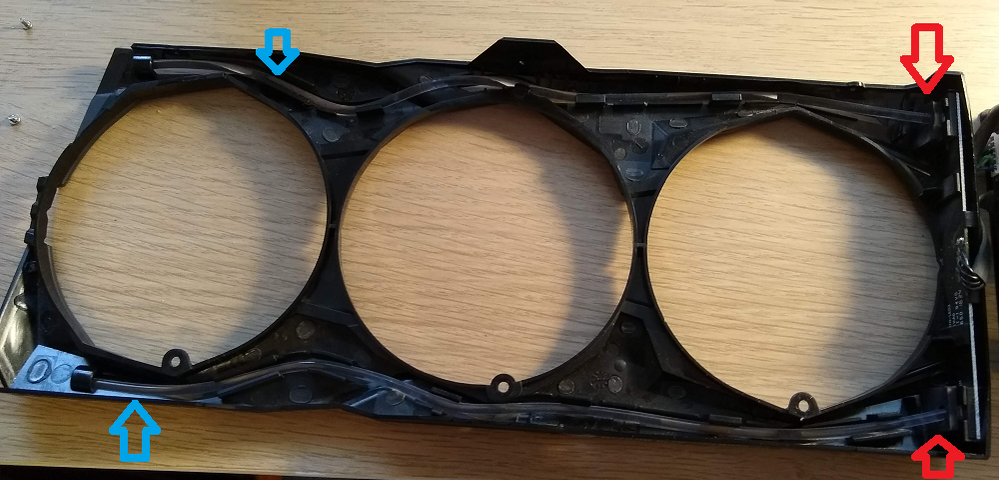

3. You will see the fiber optic cables (blue arrows) and the LEDs with a little slot for the cables (red arrows). Carefully remove the old fiber optic cables and be careful not to break any of the plastic tabs holding it in place.

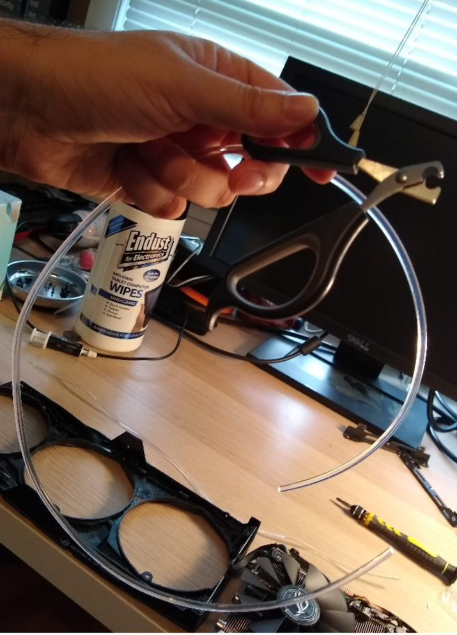

4. Get your new cable, and cut it to size. I used some cat nail clippers and they worked great. Use the old cables as a reference for how short you should cut the new cables. Insert the cables into the LED slots and then secure them with the plastic tabs running the length of the card. Make sure the cables are fully and securely inserted into the LED slot, otherwise the color could be off.

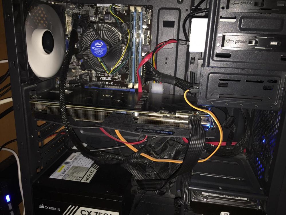

I had the same problem, followed your guide, all good.
Before:
81123

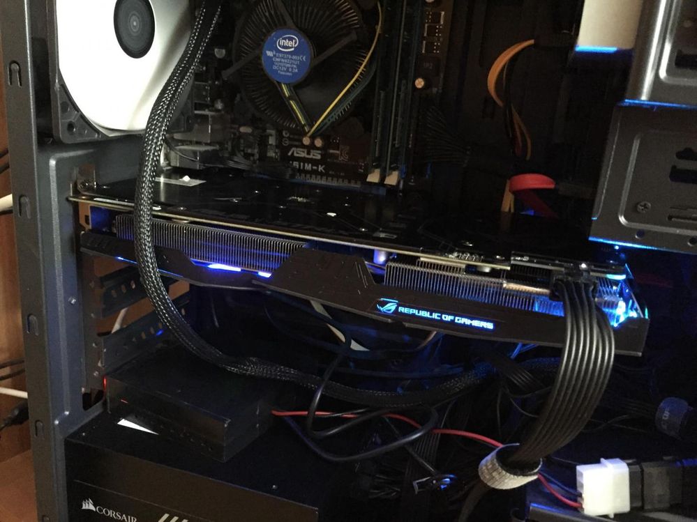

After:
81124
