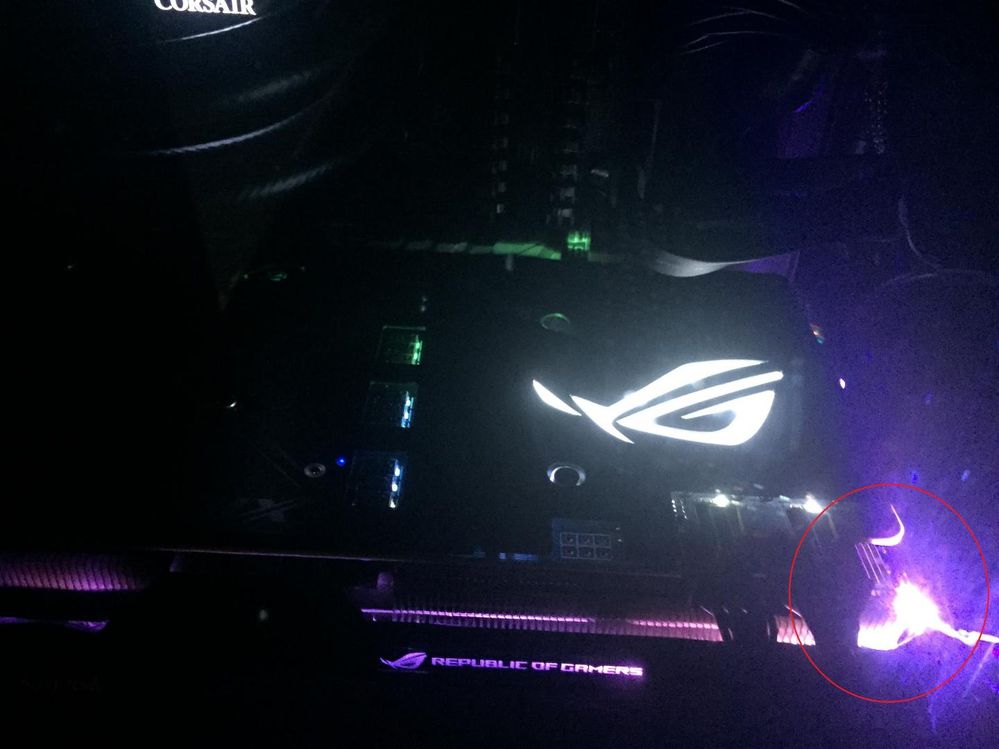

Hi, two days ago I received my 1080 OC and I am having some problems with AURA lighting - all colours seem to be ok, apart from white. The Republic of gamers logo + all LEDs underneath (around fans) are pink/violet, the STRIX logo itself is white, and one LED under backplate is locked to green - please see photo.
I am getting three different colours when white LED is chosen... I am some kind of disappointed as this was supposed to be all white LED rig build. Instead of all white I am getting all three different colours... 😞
P.S. I've just checked other colours - the LED which shows in green when set to white, is also stuck in green in orange, yellow and cyan colours. Not happy at all. I suspect a faulty LED. What do you think guys?

Thank you and yes, all in static and does not matter what shade of white do I apply it is always the same. As I mentioned eralier same happens in cyan, orange and yellow - just this green LED is stuck on. ROG, Strix logo, fans LEDS changed colours ok in that colours. White is the worst one - I got 3 different colours.
Also I have just looked at the card and one of the LEDs is much brighter than others. I have noticed that first when I took the photo, now I have looked again as it is a little bit hidden by case and it is twice as bright as the one the other side of the card (closer to MOBO). But this does not really bother me. I have just pointed it out as there may be some voltage problems on card...? See photo pls.59949
I'm getting the same result as you are so I don't think the GPU is the problem. Perhaps it's software. Give me a few days and I'll look into it.

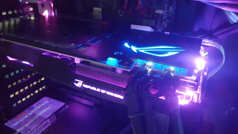

I have found on Reddit a photo of another 1080 with LED issue. I hope that it is only software problem as I like this card, it clocks to 2100.59983
The GPU has been accepted for RMA - looks like this is a GPU fault. Shame, as great GPU otherwise. Please close the thread
