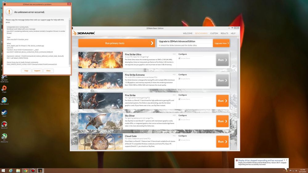

MISC/Error messages: Whenever one of the games or applications ended up crashing to desktop, it often resulted in either 'dxgi_error_device_removed' or dxgi_error_device_hung'
Please see below for one of the error messages captured when 3DMark crashed:
Unexpected error running tests.
Workload work failed with error message: eva::d3d11::rendering::deferred_scene_renderer::re nder(): draw_depth_task for thread 0: File: device_context.cpp
Line: 818
Function: struct ID3D11CommandList *__cdecl eva::d3d11::deferred_device_context::do_finish_com mand_list(bool)
Expression: native()->FinishCommandList( restore_deferred_context_state, &result): DX11 call failed [-2005270522].
Device hung due to badly formed commands.
DXGI_ERROR_DEVICE_HUNG: ID3D11DeviceContext::FinishCommandList:
