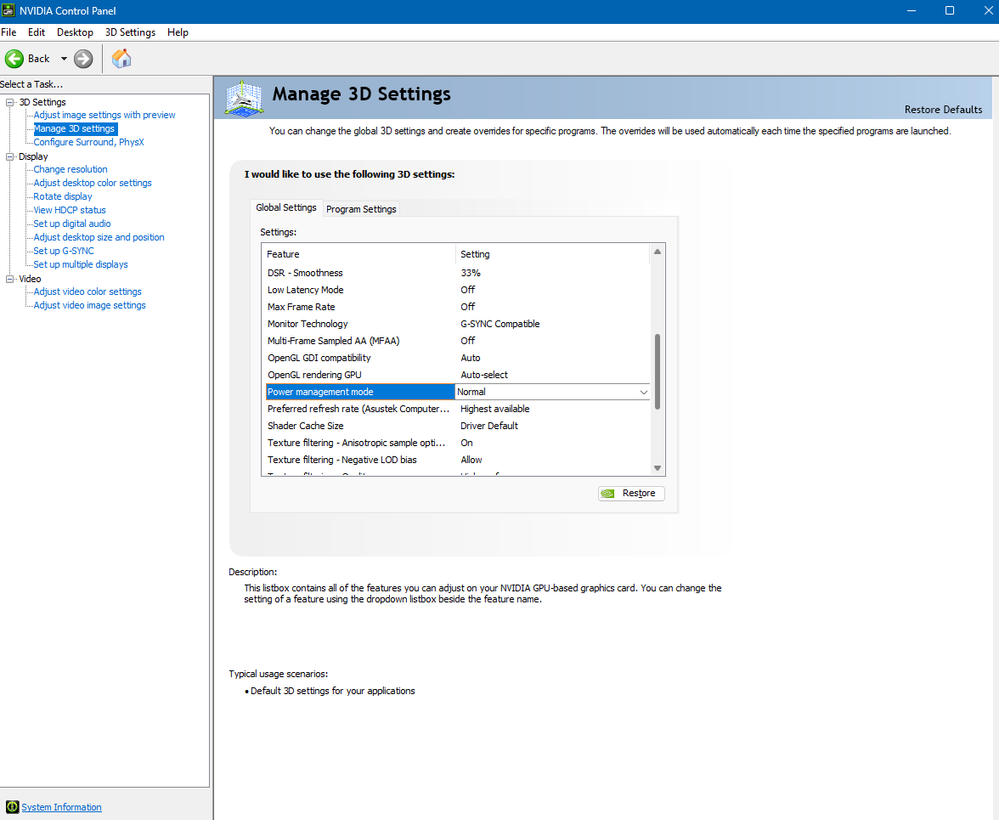

To get the idle power consumption lower:
In the Nvidia Control Panel, make sure "Power management mode" is set to Normal. If you change it, be sure to click apply and restart your pc for the change to take effect.
Click the pic to make it bigger.
Hey! Thanks for the reply. It was already set to "Normal" as a start, I checked and tried to change this setting probably at least 10 times, since it was what I originally considered could be the issue. I posted this around several forums and got many different ideas. I even contacted nVidia and Asus customer support and got some from them, too. Unfortunately, in over a week of trying to solve this issue, I was simply unable to.
