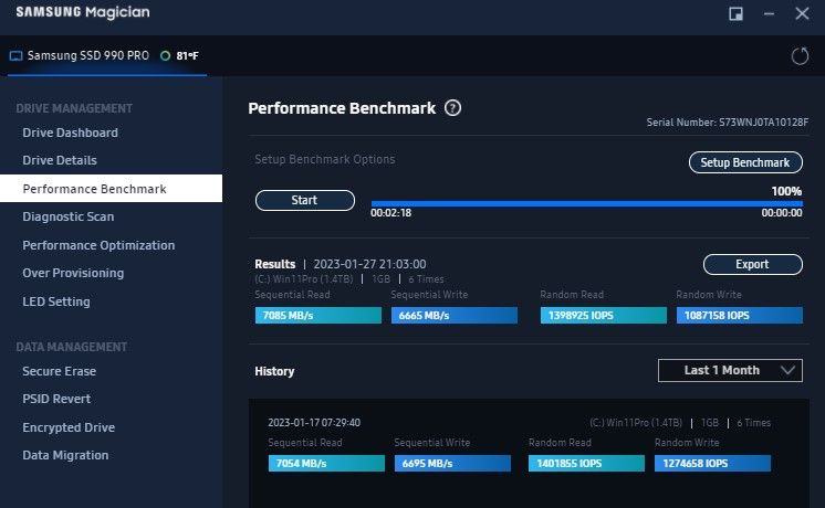

I have had the drive about two weeks and I tested it just after I got it and again just now.
97078
97079
