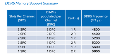

Am i reading this correctly that only 4800mts would be supported in a setup with 2 x 32gb sticks ?
the distinction between stock and what’s considered an overclock needs to be understood. Overclocking involves going beyond the manufacturer specification. However, 5600MT should be easily obtainable in the density you wish to run.
2 DIMMs on a 4 DIMM board as per the chart above = 5200MT as the maximum stock frequency, regardless of number of ranks.
