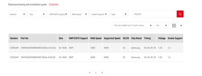

Murph, so I just looked; so is this one possible?
CORSAIRCMH64GX5M4B5600C36(Ver 4.43.02)4x 16GBXMP56005600SSSamsung36-36-36-761.251,2
What do you suggest I do to get best performance and speed for 64GB currently?
If you want to go above 6000, 2x32GB would let you do that.  Otherwise yeah, something like that Corsair 5600 4x16GB you listed above.  If it's on the QVL, it should hopefully work without too much difficulty.  All XMP memory is overclocked, so nothing is 100% guaranteed, but sticking to the QVL and more moderate speeds usually makes things easier.
