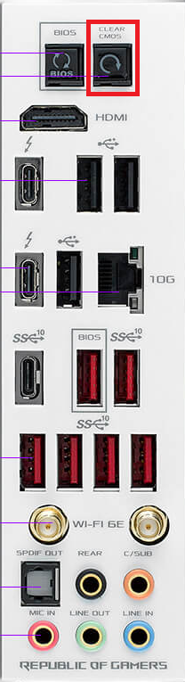

Ok, thank you for the picture, that is the correct configuration.
1) Shut down your pc and turn off the psu switch.
2) Press and hold the clear cmos button (marked red) for 3 seconds.
3) Try booting up your pc.
