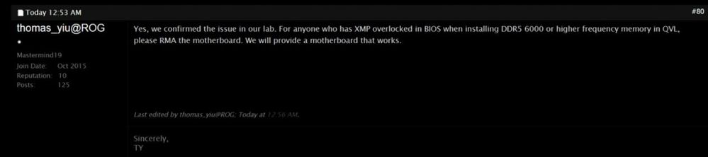

I understand people's opinion on this line of thinking, I do. But the reality is previous generations, XMP "just worked". In addition, they advertise a QVL (qualified vendor list) stating that certain memory types and speeds work with their motherboard. In many cases this is well above 6000 MT/s.
So I agree, it is for sure overclocking and I would even be OK with some tweaking being necessary if one's IMC isn't up to snuff. However, given previous generations and how they advertise it I don't see why it's a problem for people to expect it to work.
Now, I have already determined through extensive testing that my APEX board was in fact defective, I do understand the point that people shouldn't RMA so quickly sometimes. In my case, that was not at all how it went. And now, 2+ months later I am still without my computer because of this ASUS problem.
I guess I just think some people need to relax a little and maybe have some empathy for people when stuff doesn't work. No need to talk down to people who have grown accustomed to things working as advertised.

92990
Because of this !?
I bought another Apex board (which i will return). And I can clearly confirm that some of the devices are defective.
I am still waiting for RMA answer for my first board .
And the good thing is raid is still healty efen if board is replaced.

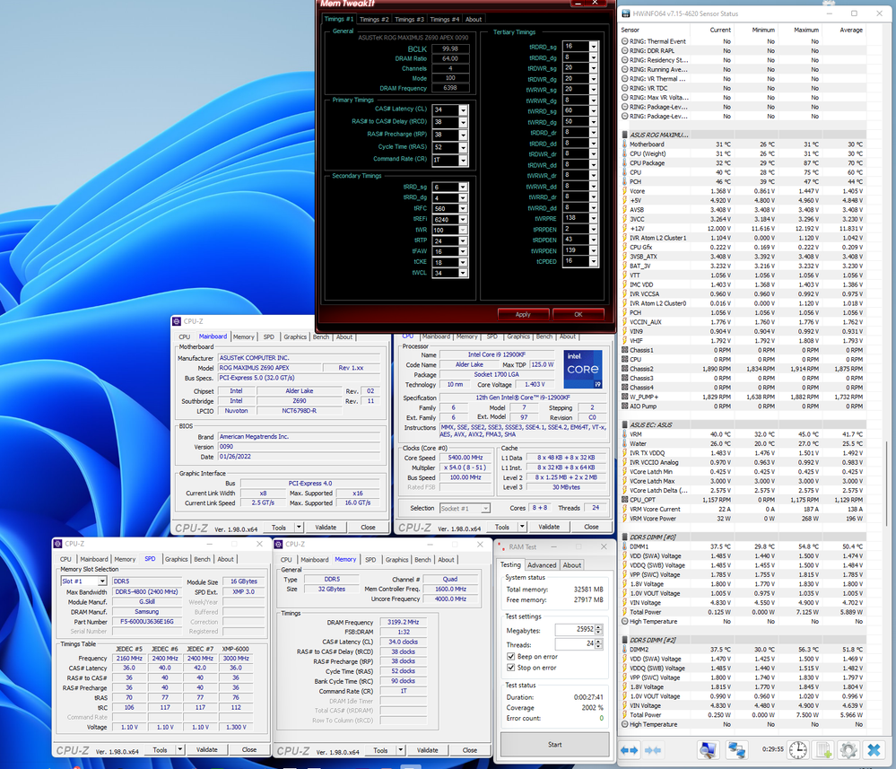

Silent_Scone
Super Moderator
Daily work horse still powering along since last year no problem after stability was dialled in at the time. Not even really felt the need to try Hynix, yet.
93395
9800X3D / 6400 CAS 28 / ROG X870 Crosshair / TUF RTX 4090
