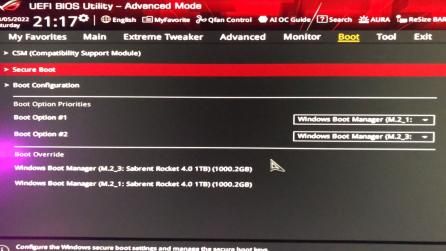

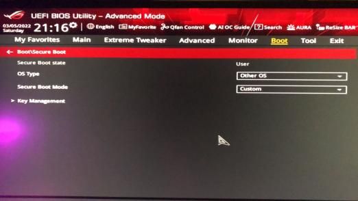

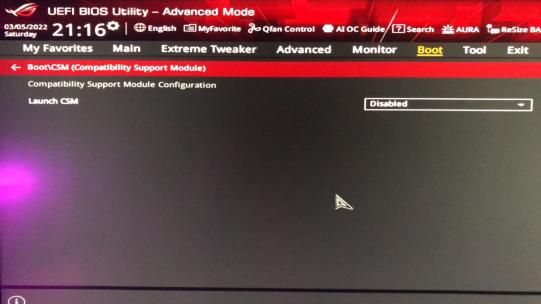

I've had this problem at some point.
I even bought the license (can install on future hardware) to never go through this again.
But at the time, these BIOS setup tips helped me:
92355
92356
92357
I just don't know if in this new Win11 it will be necessary to reinstall it.

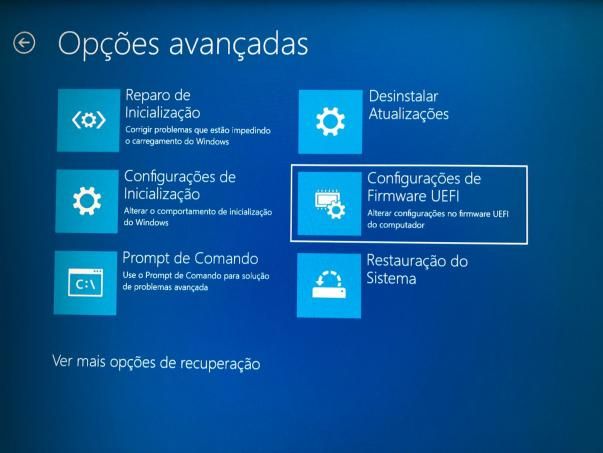

I'm going to make a CRAZY suggestion.....as a last resort, I would do:
1) In the safe mode advanced options I would try the option to configure UEFI firmware.
92358
2) If it doesn't work, I would download and do a clean install of Win11 (have the Win10 keys at hand)

I had (for the first time when updating to BIOS 1304 on a Hero Z690) the 2.5G LAN port fail to start with a "Code 10". Tried everything including rolling back to 1003 but the issue remained. Finally, looking in the BIOS, I found "Secure Boot" had magically been disabled and re-enabling it (set "Windows UEFI mode" and the option below it which I changed from "Custom") and the LAN port came to life.
You folks aren't actually showing your OS as Other OS are you?
