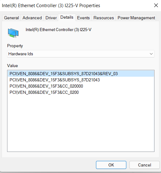

Hi I am not sure how to check the firmware it is the stock one that came with the board. The driver is 2.0.1.3 I have tried a few drivers now all with the same result I keep losing speed and it goes to 100mbit connection instead of 1gbs that it should be, If I disable the adapter and re enable it goes back to 1gbs and my full download speed again.
Apparently this is Rev 3 and this has been happening to this adapter since the first revision and Asus continue to use it,
I may have to send this board back if this is not fixable soon otherwise I am going to be stuck with a nic that just doesn't work and is ridded with these issues.

This is all I have in the info, It is Revision 3 but I didn't know there was a firmware available however this adapter apparently has had issues for all the 3 revisions of it's release.91148
