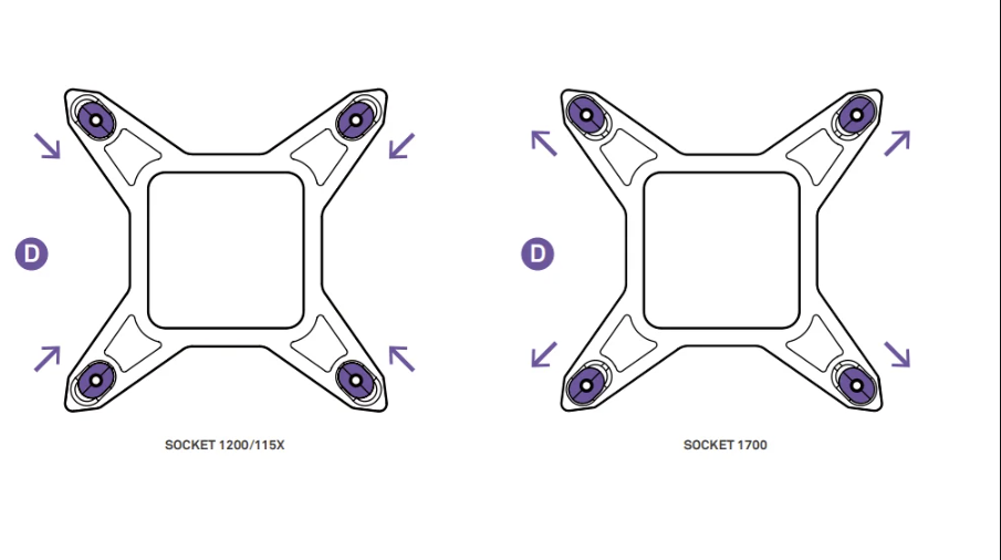

What I suspect is not proper contact between the AIO and Motherboard. (Although i cannot screw it down any further and no plastic stickers under the block.) what i did notice is that the Asus motherboard has "multiple" mounting holes and i was curios which ones people use. The outer ones or the inner ones, since the AIO mounting bracket can accommodate both. (See attached picture for reference).

Just to clarify, nothing is in the way or not being installed properly from the AIO point of view. My only question was which holes the asus folks tend to use, since these "multiple holes" are asus specific. other motherboard vendors only have one hole to mount the backplate and cooler (also the Corsair install guide, also just states stick it through the hole). My question was do i use the hole closet to the socket or furthest. I dont know why there are two holes per mounting place, i tried checking asus motherboard manual but nothing. my only conclusion is so it supports older coolers (but why would you use an older cooler on a newer cpu????) .

The mounting point offset is for past gen socket cooler compatibility. It should be evident from the 150i design and included brackets which ones you need to use for LGA 1700.
I don't believe that is to do with your issue. I would inspect the DTS temperatures within HWINFO64 and check your core deltas. If there is a sizable difference between P-Core delta (10-18c or more) you may benefit from using a contact frame as previously mentioned.

It should be evident from the 150i design and included brackets which ones you need to use for LGA 1700. <-- This is the point, the mounting points for the backplate for the h150i can move diagonally, so they can match the outer or inner hole. the only lga1700 specifics from the AIO is the standoffs that screw in. I can find no documentation from ASUS anywhere that states the outer holes are lga1700 and the inner holes are LGAxxxx or reverse, hence my question does it make a difference then?backplate.jpg
The mount for the LGA1700 is wider in diameter.
9800X3D / 6400 CAS 28 / ROG X870 Crosshair / TUF RTX 4090
Thanks, its currently installed in the outer holes, as i found something similar when installing the backplate. This post was more a curiosity check to see if anyone deviated. (and now i wonder why ASUS would allow older cooler support on a high end motherboard like this, z790-e wifi II, as this sounds like a very bad idea. but anyhoo.)
