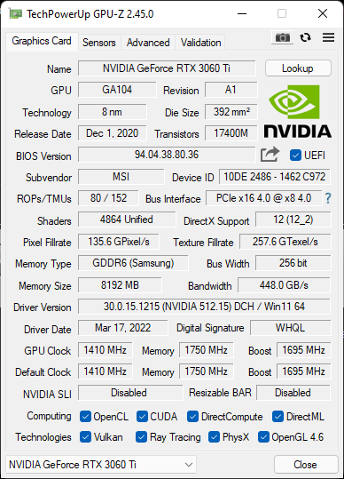

I have an issue with the bandwidth of the PCI lane on my motherboard, it is a z690 as it says in the title, and the GPU is a RTX 3060Ti

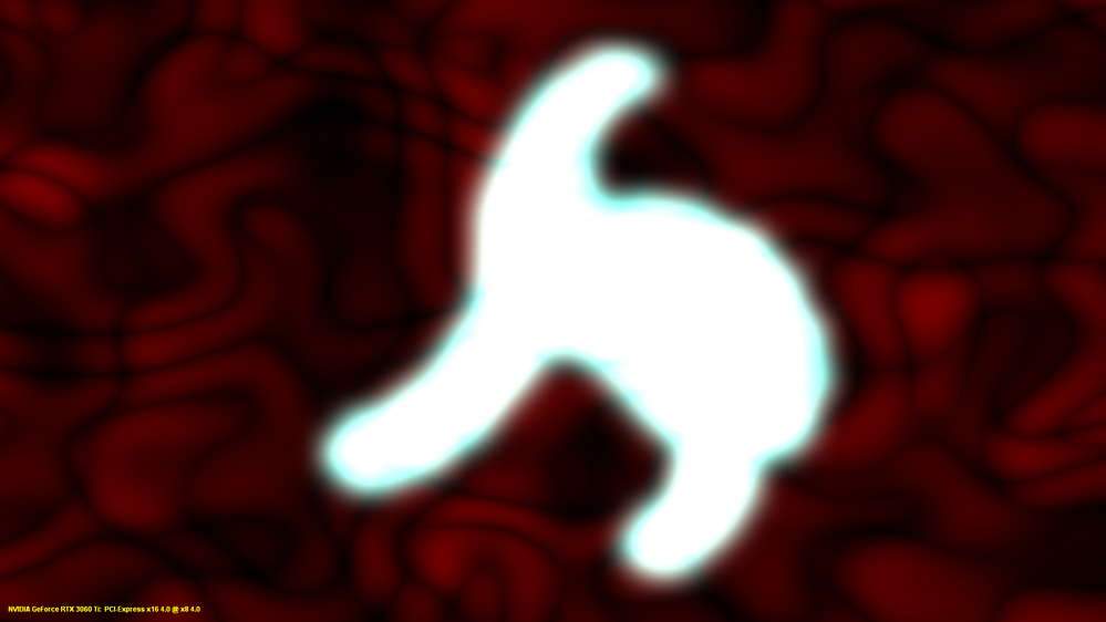

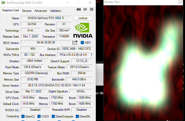

Well the issue is that GPU-Z says the bandwidth is x8 insted of x16, no matter what I do (start render test) here is some snapshoots

The moment you use any other PCIe x16 slot (your soundcard in this case)
The #1 slot drops to x8

Edit: I just took out the soundcard and keep saying the same thing (x8), and even try to run red dead redemption 2, still no change.
Maybe is just the gpu-z reporting it wrong?
thoughts?
Do you have an M.2 drive in the top bay (M.2_1)? It shares lanes with the top PCIE slot (the GPU slot), so putting an M.2 drive in M.2_1 will also drop the gpu slot to x8. M.2_2 and M.2_3 can be used without impacting the top PCIE slot, as can the HyperM.2 Card in the bottom slot.
GPU_Z reports fine for me. I have a 3090 in the top PCIE slot, Samsung 980 Pro nvme drives in M.2_2 and M.2_3, and the HyperM.2 Card in the bottom slot currently with (1) Samsung Pro nvme. GPU-Z shows x16 for my 3090 when rendering.

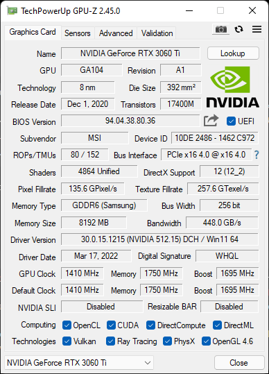

It was the m.2 slot causing the problem.
I changed my m.2 drive to M.2_2 slot like RogScott say (thanks) and that solved it, now GPU-Z shows x16
92647
