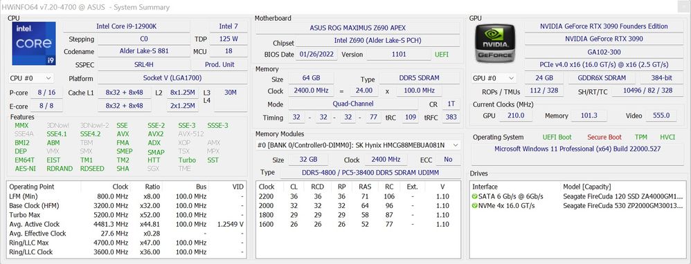

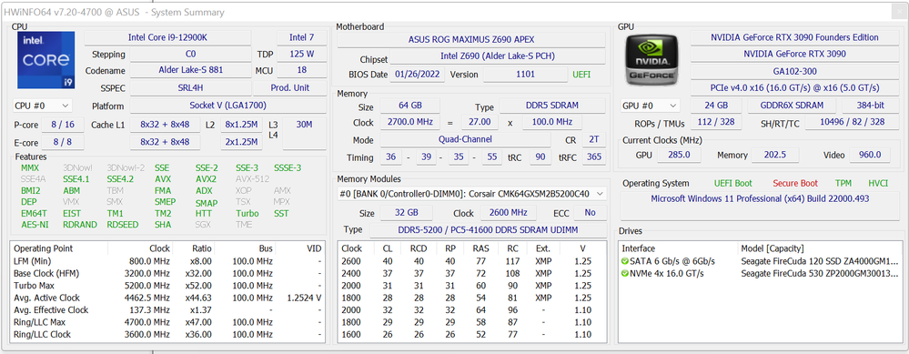

I have the Corsair Micron 2x32GB 5200MHz CL40, Dell SK Hynix 2x32GB 4800MHz kits and both are working fine in XMP 1 profile on Apex board.
Not sure which motherboard you have, I have tested the memory preset profiles in BIOS for 2x32GB Micron, Hynix and the pre-set profiles also work fine.
Corsair 5200 kit:
92200
Dell 4800 Kit:
92224
