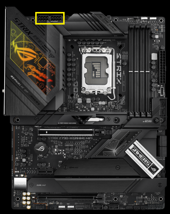

If it doesn't boot, shut your pc down and turn off the psu switch. Try connecting both 8-pin cpu power cables. Your psu has one 8-pin cpu power cable and one 4+4-pin cpu power cable.
Both cpu power cables are already plugged in. I'll try the clear cmos again but I'm pretty sure it worked cause it reset the clock.
