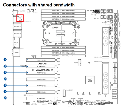

Hello, I have a new board yesterday I received a Pro WS W790E-SAGE SE assembled a new computer but a VBAT sensor
1.71 Volts is red in the bios what should I do to replace the battery where to buy it and how to change or change the rma card?

The CMOS battery is located here as per the manual:
The battery is a CR2032 lithium battery which should be available in most retail outlets or supermarkets.

and how should it be replaced? Is there any rukavodstvo?
The battery is easily removed by hand, it's simply latched in place with a small metal clip.

Hello dear. Tell me, in order to remove this cover, do I need to unscrew these 2 bolts?
the battery is not easy to remove, you need to remove the plastic casing and peel off the battery from the metal plate on which it is glued
