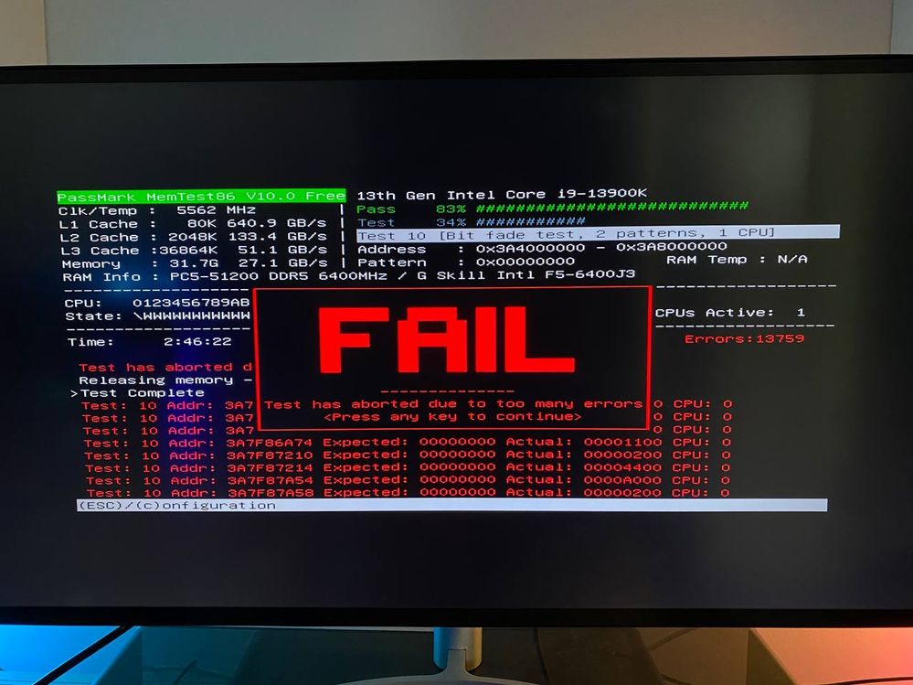

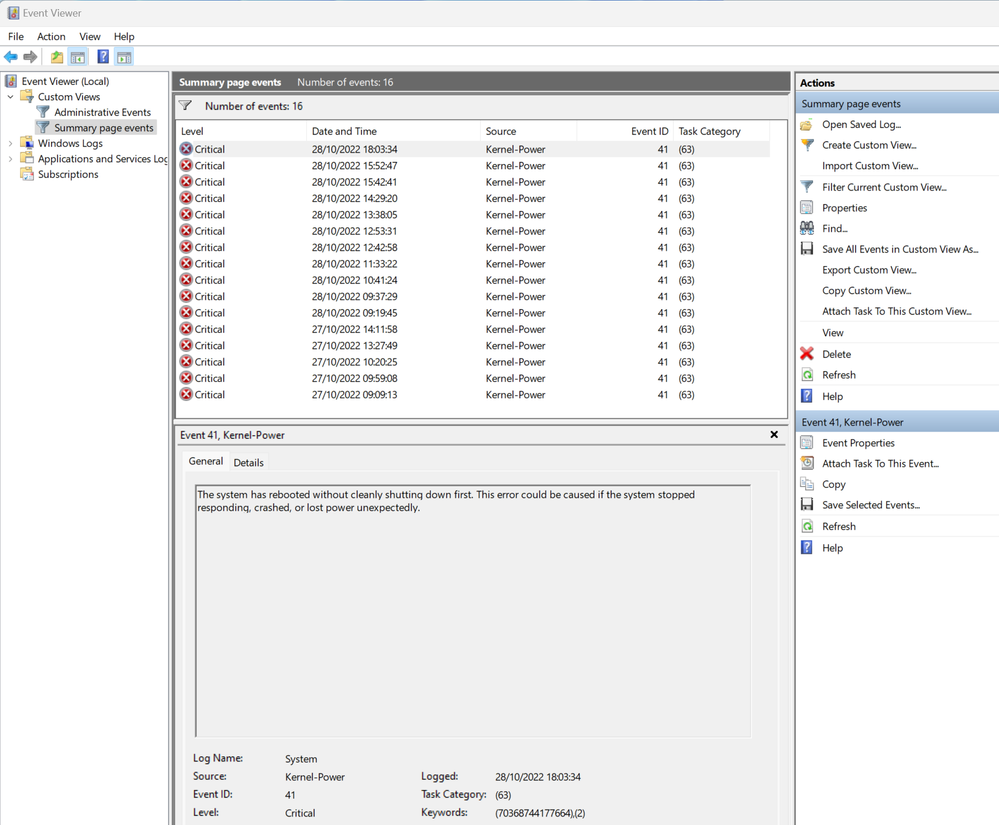

After being a Mac user for 9 years I have decided to build my dream PC now that the 13900k came out. This dream has turned into a nightmare so far. My system is rebooting around 5 times per day whenever XMP is enabled. So I reached out to Microsoft forums in the first place and no one could help me 😞

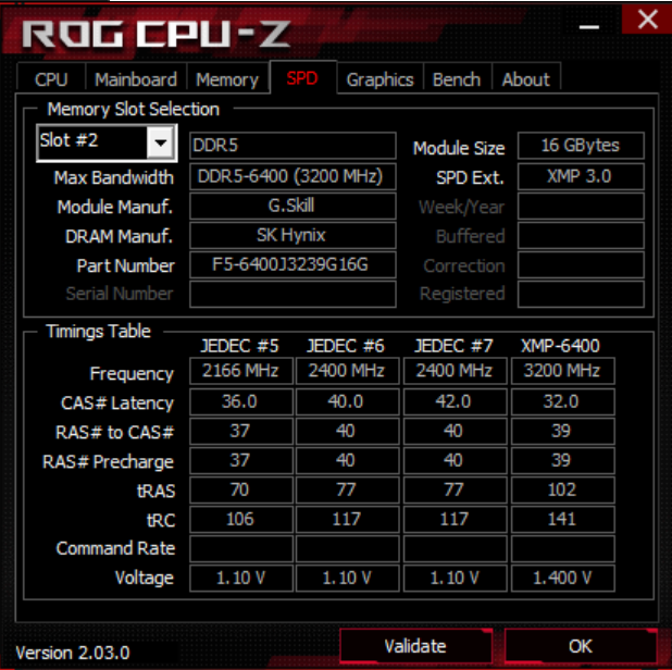

I have a pair of F5-6400J3239G16GA2-TZ5RS sticks. Updated all drivers and even Bios and everything I could find on asus website.

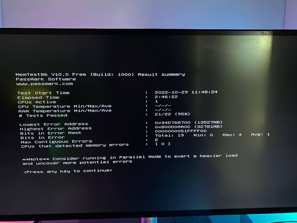

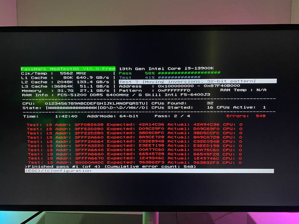

Whenever XMP is enabled my system is bloody unstable and it restarted even while I was writing this just now. The MEMTEST86 failed big time, but when XMP is disabled the MEMTEST86 came back with no errors.
I have ordered a new pair of ram sticks that should arrive tomorrow. I dont know if it is the motherboard or CPU or RAM to be fair. I am refusing to use them without XMP, what is the point then? 🙂 please see screenshots of my nightmares:

Thanks Jackson, the rams were in the right slots... I ran memtest86 on both of them individually in Slot A2 xmp I enabled, they both failed big time 😞

MoKichu has helped me out and all my BSOD errors went away with . couple of firmware updates. He also determined that my rams are not compatible with my motherboard, my mistake as I misread the ram info on the asus website. Ordered a pair of Kingston FURY Renegades and I hope there wont be any future issues with that.
