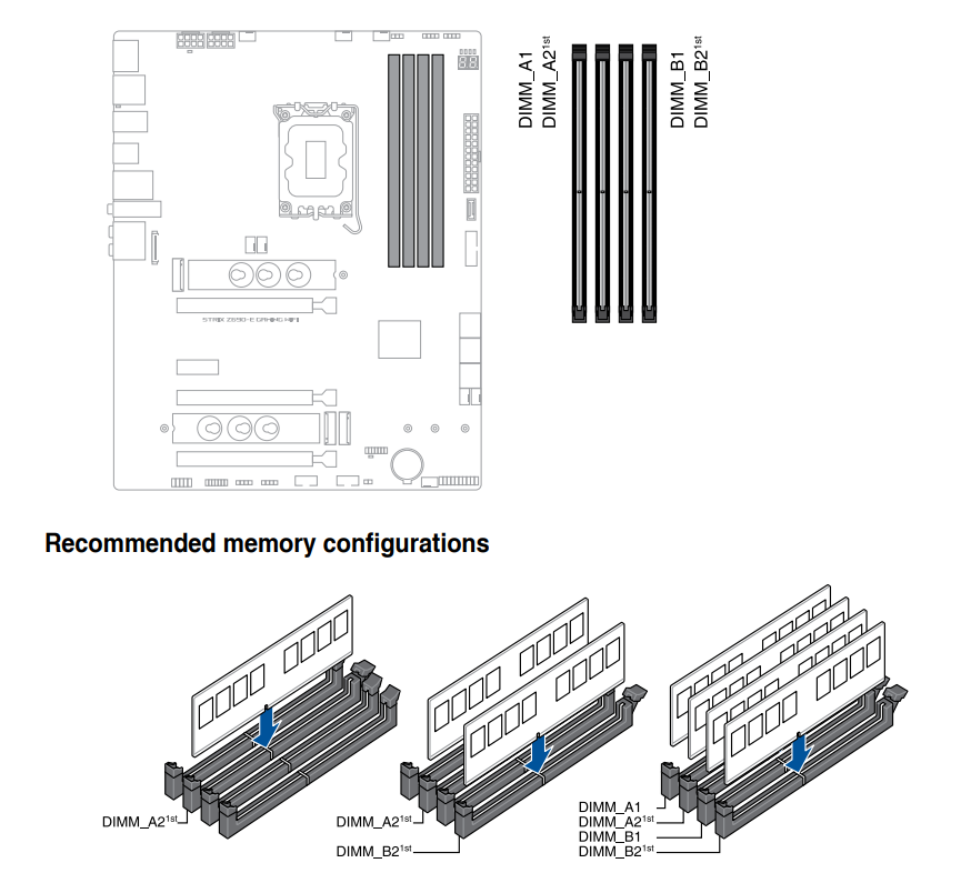

Technically it should work, but according to the manual, a single dimm configuration is the A2 slot.
95118
I have put the same module (1x16GB) to the B2, and Memtest was OK, XMP was working.
Yes, I see on the motherboard manual book that the A2 slot is the recommended for single ram.
Now I put the same single module to the A2, and Memtest was OK, but XMP did not work: long time black screen, many restarts and finally I got the BIOS safe mode screen.
Should I think the motherboard is broken? (I will check the A2 slot with other memory module)

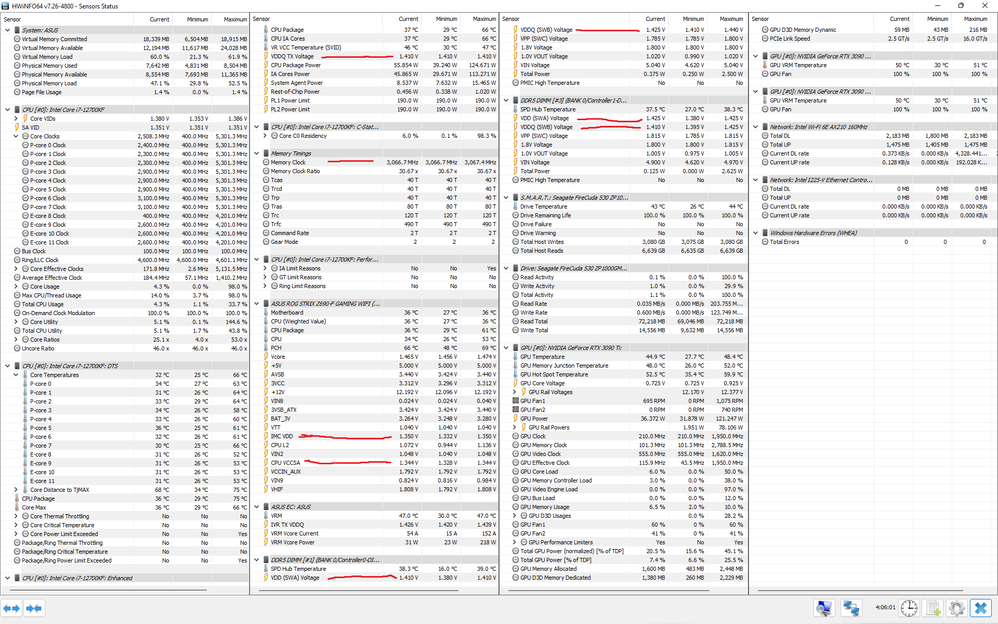

You need to raise the voltages I listed above to achieve stability. One module is 16GB, as mentioned I had to raise voltages to get 16GB 6000MHz stable.
Write the voltages down on a piece of paper and start with the lowest values first.
Here's a screenshot of my Hwinfo, click the pic to make it bigger.
95119
