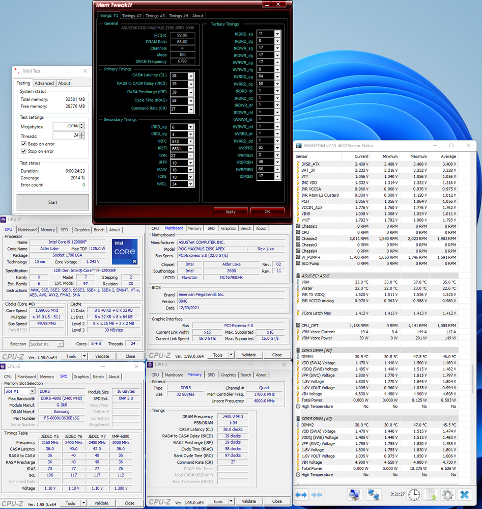

Rough Description at Gear2:
Fmax VDD VDDQ TXVDDQ MC VDD SA Able to run CMD Rate 1T
2* Hynix SR 5800 1.3 1.25 1.25 1.25 1.25 yes
4* Hynix SR 5200 1.2 1.2 1.2 1.2 1.25 no
2* Hynix DR 5400 1.3 1.25 1.25 1.25 1.25 no
4* Hynix SR 4200 1.2 1.2 1.2 1.2 1.35 no
2* Micron SR 5600 1.35 1.4 1.4 1.34 1.2 no
4* Micron SR 5200 1.25 1.25 1.25 1.25 1.25 no
2* Micron DR 5400 1.25 1.25 1.25 1.25 1.2 no
4* Micron DR 4200 1.2 1.2 1.2 1.2 1.35 no
2* Samsung SR 5800 1.435 1.435 1.435 1.34 1.25 yes
4* Samsung SR 5200 1.35 1.35 1.35 1.25 1.25 no

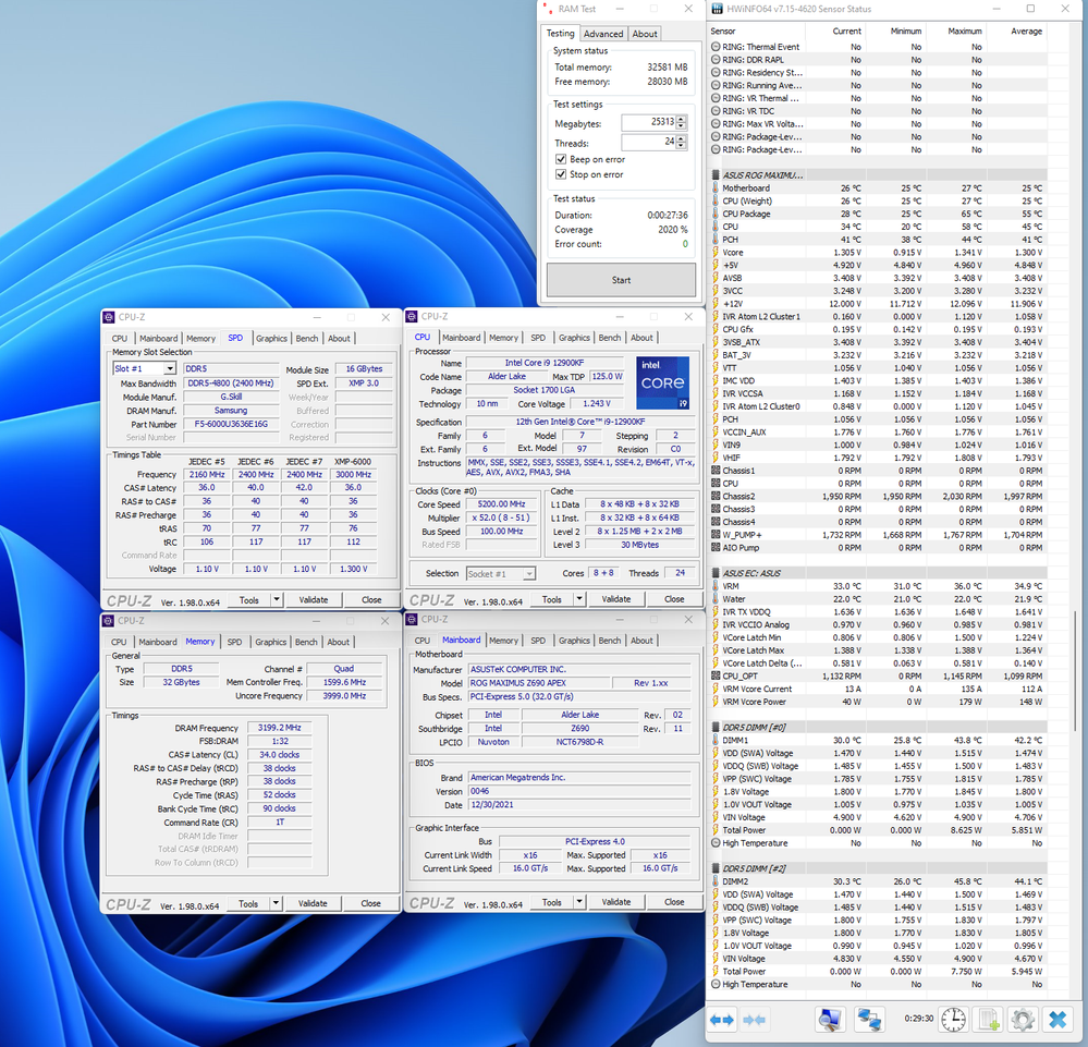

TX VDDQ 1.52
6800 C38-39-39-58 2T
91694

Very good! I am wondering what is better for system performance: Maxing out the memory frequency, in your case to 6800MHz, with relaxed timings, or reducing frequency to lets say 6200MHz and tighten timings?
Hello, both are intrinsically related. Tighten down at the maximum frequency you can obtain at 1T.
9800X3D / 6400 CAS 28 / ROG X870 Crosshair / TUF RTX 4090
In my case I saw about 2.5% performance increase going from 5400 32-32-32-96 to 5600 40-40-40-102. So it seems although 5600 timings are slower by about 2.5 nano seconds, they somehow gain better transfer rate in real-world scenarios (more GB specially favoring multi-core tests). There is also an article from Crucial about the true-latency that basically says the same thing. While both factors are important, marginally worse timings with higher frequencies perform better than tight timings with a lower frequency.

All sub timings are currently board-controlled.
6400 C34-38-38-52-1T
Per C 54/53/52
Cache 40
E Core 41 Sync
MCVVD 1.4
SA 1.18
VDD 1.48
VDDQ 1.48
VDDQTX1.66
92069
