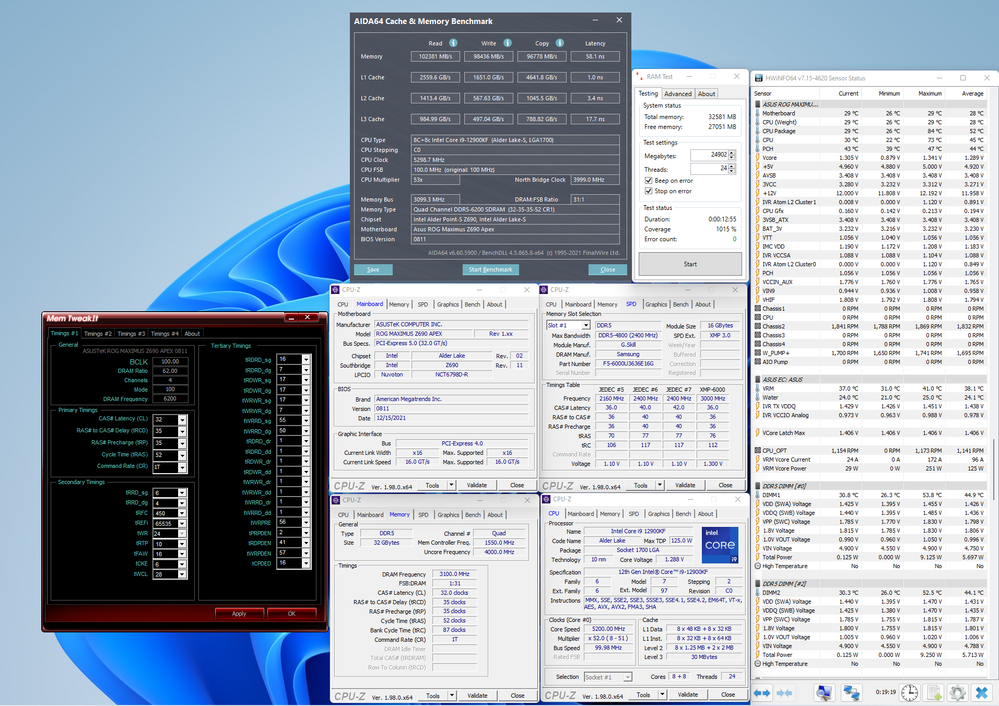

F5-6000U3636E16GX2-TZ5K (6000-C36)
6200 CAS 32-35-35-52-1T
Apex 0811
Per Core 54/53/52
E-Core 41
Cache 40
VDD 1.435v
VDDQ 1.435v
VDDQTX 1.435v
VCCSA 1.1v
MC VDD 1.2v
91249

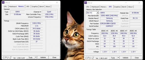

very nice numbers, 6600 is just outstanding, really appreciate you sharing these as it gives me hope for 6000 on my 5600 stuff. I see that you ran with just 1.2v on IMC VDD, seems to worked well overall, mine are below...
F5-5600U3636C16GX2-TZ5K
Maximus Extreme 0002
VDD 1.25v
VDDQ 1.25v
VDDQTX 1.25v
VCCSA 1.1v
MC VDD 1.25v
91324
Silent Scone@ROG wrote:
6600 CAS 38-39-39-58-2T
Apex 0811
Per Core 54/53/52
E-Core 41
Cache 40
VDD 1.45
VDDQ 1.45v
VDDQTX 1.45v
VCCSA 1.1
MC VDD 1.25v
Attachment 91315
saw this after I posted, see now you have increased the MC VDD, how is this working for you now?
Per Core 53/52 with 12900KF
VDD 1.40V
VDDQ 1.40v
VDDQTX 1.40v
VCCSA 1.25V
I was initially hesitating to increase the memory voltage above 1.30v, because 1.30v is in my case (690-F + 12900KF + DDR5/4800 Samsung) the AEMP auto setting for 5800 MHz. With 1.30 volt I could run 6000 MHz with CL 34. At 1.40 v I can get it now running at 6200 MHz @CL 34, stability / error tested with XTU. I could probably push it to 6400 MHz with further relaxed timings and reduced stability.
It's nice to see that DRR5 seems to scale very well with increasing voltage. Most probably DDR5 will allow for even higher MHz with increasing maturity. However, I can't see any impact for gaming between 5800 MHz @ CL 32 and 6200 MHz CL 34. Considering that my DIMMS are supposed to run at 1.10v, I don't think it's prudent to keep them constantly running 30% overvolted. I'm now back to comfortable 5800 @ CL 32 @ 1.10v.
91333

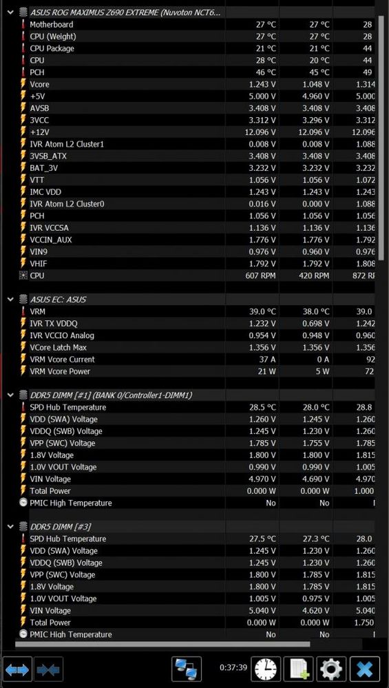

VDD 1.25v
VDDQ 1.25v
VDDQTX 1.25v
VCCSA 1.1v
MC VDD 1.25v
91324
Hello,
My CPU likes around 1.2v for 6000-6200 however an increase to 1.25v was needed in order to get 6600 stable.
You'll find if the MC VDD is insufficient it should throw errors fairly quickly.
