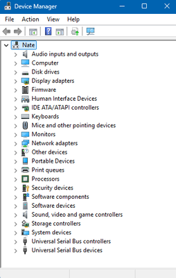

Does Device Manager show any missing drivers?

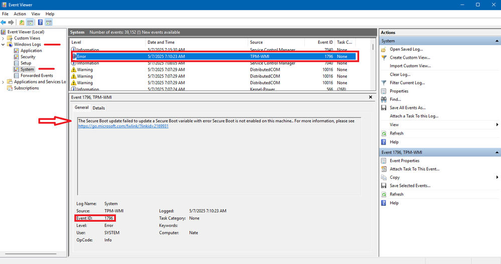

After your pc crashes, check Event Viewer, it can tell you what is causing the crashing.
