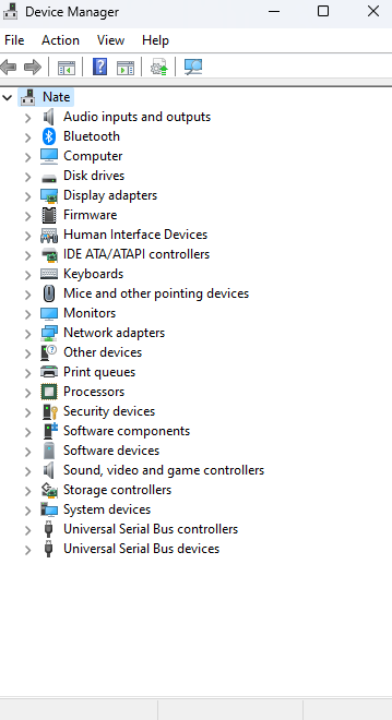

Also, make sure windows and the graphics driver is up to date.
You can check device manager for any missing drivers.

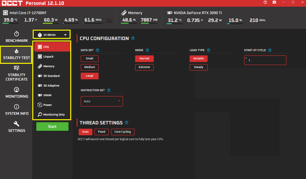

There is a program called OCCT you can run to test your components for stability, maybe it can help point to what's causing the freezing.
Download OCCT Personal, you don't have to run the tests for an hour, if there is a problem, it will usually show within 5 minutes.
OCBASE/OCCT : Free, all-in-one stability, stress test, benchmark and monitoring tool for your PC
Here is a screenshot of the tests you can run.
I ran some tests in OCCT and it was all clear. Ran the power test which loads everything up so there is high demand on the PSU and it was stable. I only ran it for 10 minutes but I might try a longer test later (when my electricity is cheaper, lol).
So there don't seem to be any component problems.
