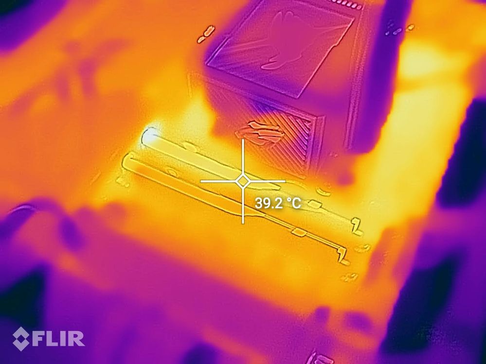

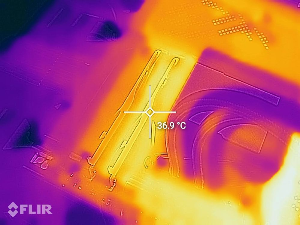

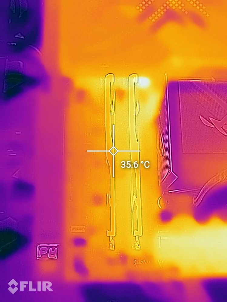

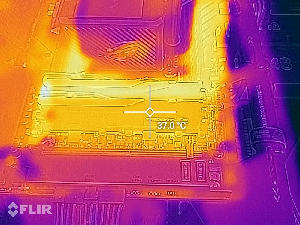

Hey there guys!
Thanks to Hopper64 and Shamino, I've managed to run two sticks of G.Skill DDR5 6000 MHz CL36 16GB modules on Z690 Extreme...and now here's my worry.
I know zip about DDR5, I know very little about DDR4 so...
I'm running 2second full run of MemTest on my benchtable and my average temperature of RAM stick is 40°C [+-], most of the time it hovers on 32 - 36°C, but there are ones and zeroes and one more test, that pumps the temps of sticks up to almost 60°C.
I have no errors whatsoever.
My question is, I plan to run two kits, on let's say 5600 MHz, or 5200 MHz, I'll see how they run and if they run together at all. I'd like to keep "vanilla" XMP I. or XMP II. profile with Hopper64's VDD 1.35 and Shamino's VDDQ 1.3575. They keep my RAM steady!
But my temperatures are as follows:
91536 91537 91538 91539 91540 91540 91541 91542 91543 91544 91545 91546 91547 91548
Are 35 - 40°C in most of the tests okay? And 55°C - 60°C in 1s & 0s and hammering in MemTest?

Silent_Scone
Super Moderator
Hello,
Those temps are normal, especially without active airflow. Thanks to the PIMC the modules pack more heat.
This is well within tolerance, the only "danger" is when pushing the modules to the edge of stability as when stability margins decrease, so does the module's tolerances to temperature and active airflow might be required to sustain overclocking stability (anything above 55-60c can become problematic for stability with Samsung IC).
All par for the course, and simply needs to be kept in mind when pushing the memory IC limits.
