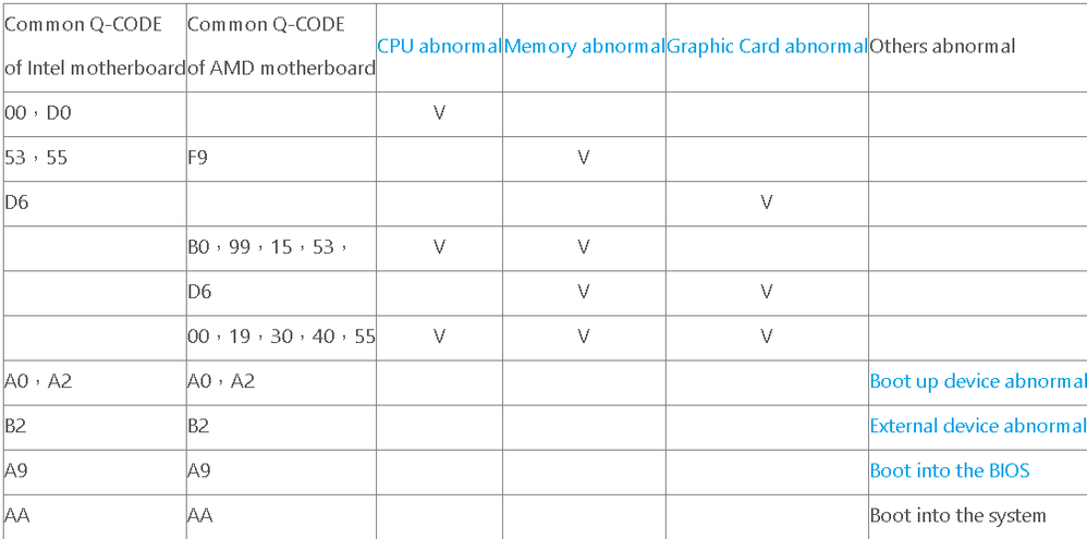

According to this, code d6 is a gpu related error, but I find it strange you get code d6 with just two bios versions.
Are you sure it's code d6 and not db? Code d6 will have a line across the top of the 6.

Now that you point it out, I don't think I saw a bar above 6.
The message appears after the post DETECT HDD
I see that if it is indeed d6, in the manual it would be "No console output device was found"?
