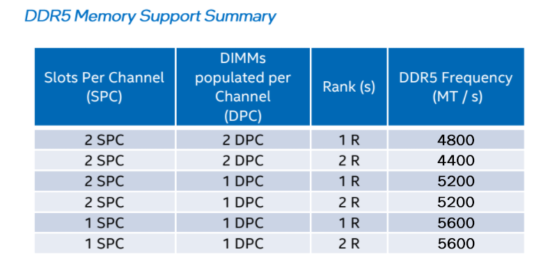

1. Using a single stick reduces the number of channels to the IMC and is easier for the CPU to cope with. The chart below shows the maximum operating frequency for 14th Gen processors. Note that the maximum operating frequency for a Two Slots Per Channel (2SPC) motherboard with single or dual rank modules (SR, DR) in One DIMM Per Channel (1DPC) is 5200MT. Anything beyond this is classified as an overclock, and may require manual tuning due to variance when running the system out of spec. Did you try lowing the frequency to see if this helped stability?
More Information on XMP
2. If needing to ask which kit, I would opt for the slower frequency if you do not want to tune manually. Note that the higher the density, the more likely user intervention is needed.
You can use some pointers from my 8000MT guide which may help you dial in.
Regarding the comments about the KS having issues where the K doesn't, that statement is false. Both the K and the KS are based on the same die. As Intel does not bin their CPUs for memory controller capability your mileage will vary on each sample.
