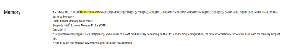

If we look at the technical specification you can see the max validation is 7800MT. Normally, I recommend that users opt for a kit one or two ratios below the max validation for best chance of success without manual adjustment outside of XMP.

I'm using the Z790 Apex. The Apex is 1DPC (1 DIMM per channel) and validated for 8000MT. Motherboards with only two memory slots generally have an elevated OC range due to less crosstalk and signal degradation. Generally, you should pay attention to the maximum validation on the support page. If a frequency isn't listed, your chances of obtaining it will become greatly reduced or in some cases not possible.
