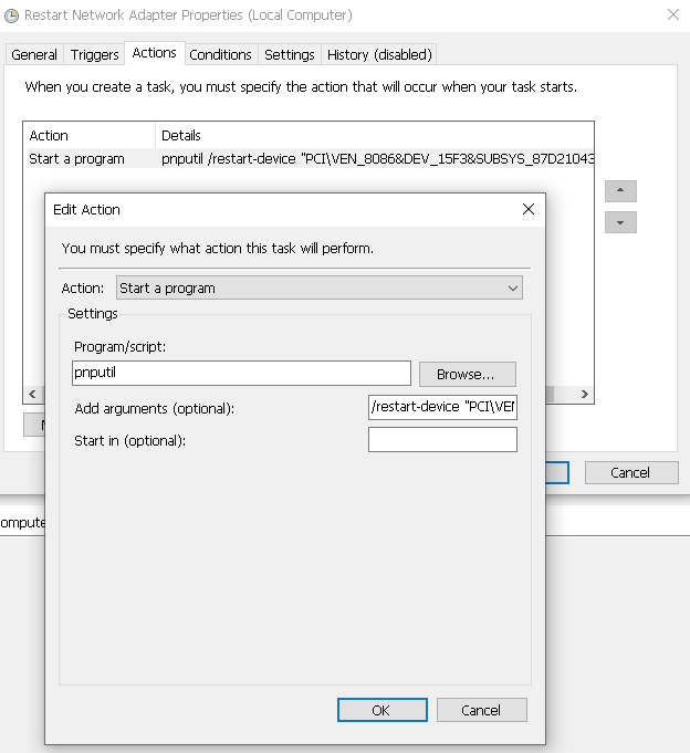

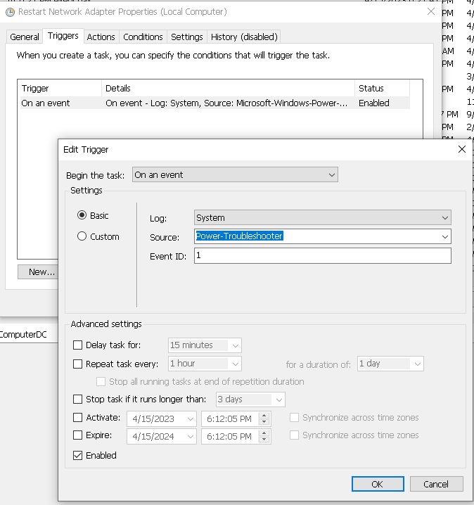

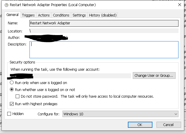

To implement the workaround automatically, I have created the a scheduled task. The task is tiggered on System event log, Power-Troubleshooter source, event id 1 (wake from sleep). The action is

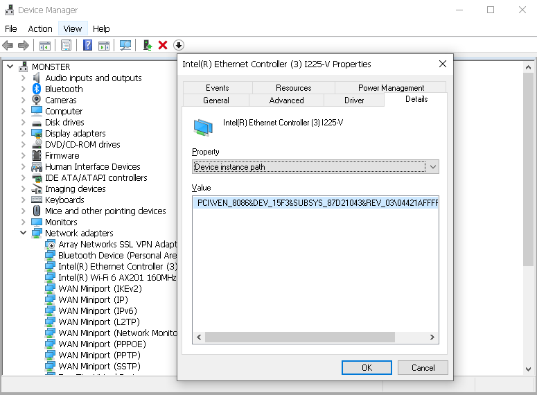

pnputil /restart-device "<my device instance path>"
You can get the instance path by right DevManager.PNGSchedTask1.PNGSchedTask2.PNGSchedTask3.PNG
