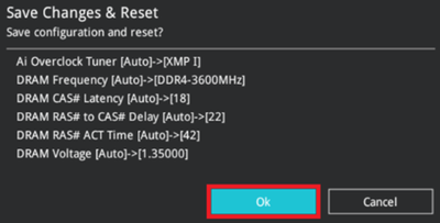

- the images of the BIOS main page and all the manually adjusting items as the image
