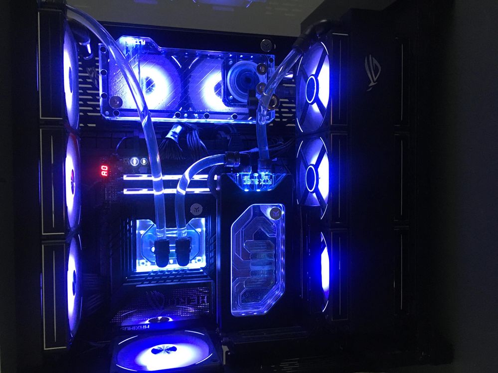

What Max Core Frequency should the 12900KS be doing out of the box and should it be Power Limit Throttling at the Intel stock settings with no motherboard enhancements turned on ?
I am using a custom loop system so I would like to think my cooling solution is good enough for the job.

92915
My setup should be able to keep these temps in control but it cant. I would have an extremely ruff time if I was to cool it with air cooling or even an AIO.
USERMAC wrote:
92915
Is that two rads and a CPU as well as a GPU in the same loop? Took me 4 rads with 2 of them push pull and all extreme rads too to tame two GPUs and a 10980XE Ocd to 4.8 Ghz all cores Im actually pulling two of those rads and installing a MORA3 with 8x 200mm fans.
