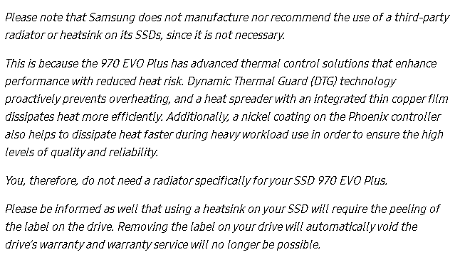

Here is a reply from Samsung, the last paragraph would explain your higher than normal idle temps.
Removing the motherboard heatsink may give you better temps.

Hi thank you for that.
Hmm so Samsung actually recommends that I do not use the thermal pad that comes with the Asus Maximus XII Hero.
Maybe i'm all doing is trapping the heat further? Since the NVMe is under some "cover" (the little plate where the thermal pad is stuck to) and ontop of it the GPU is over it.
