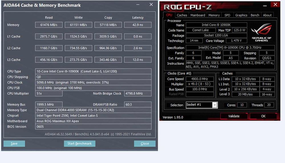

Hi, let me start with this, I have an Asus APEX XIII. The problem is that I turned up the processor to 5.0GHZ at 1.35.
Why doesn't it keep these MHZs all the time and why CPU-Z shows 1.488V?
My processor is 10900k and Kraken x73.
What's more, I can't go down with delays below 40ns ....
Any suggestions ?88521

CPU-Z Displays the VID which represents the voltage the CPU believes it's receiving. Use HWInfo or a suitable monitoring tool to monitor the Vcore.
On the Apex you may want to try running Command Rate 1 to help reduce latency. You may likely need to increase DRAM voltage in order to find stability, however.
