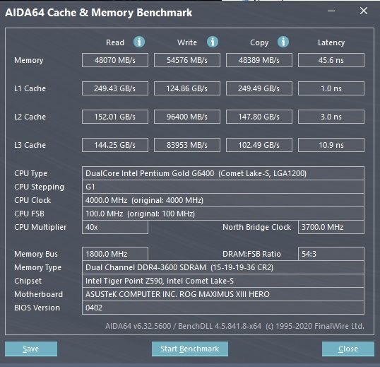

So, I'm currently experimenting with my RAM (4x8GB), and i was just wondering if the lower Read / Copy speeds (lower than Write) are normal.
Shouldn't i see very similar results with all Read / Write / Copy ?
** Ignore the Pentium G6400, i know... xD It's just a temporary chip till i get the i9-11900K 🙂

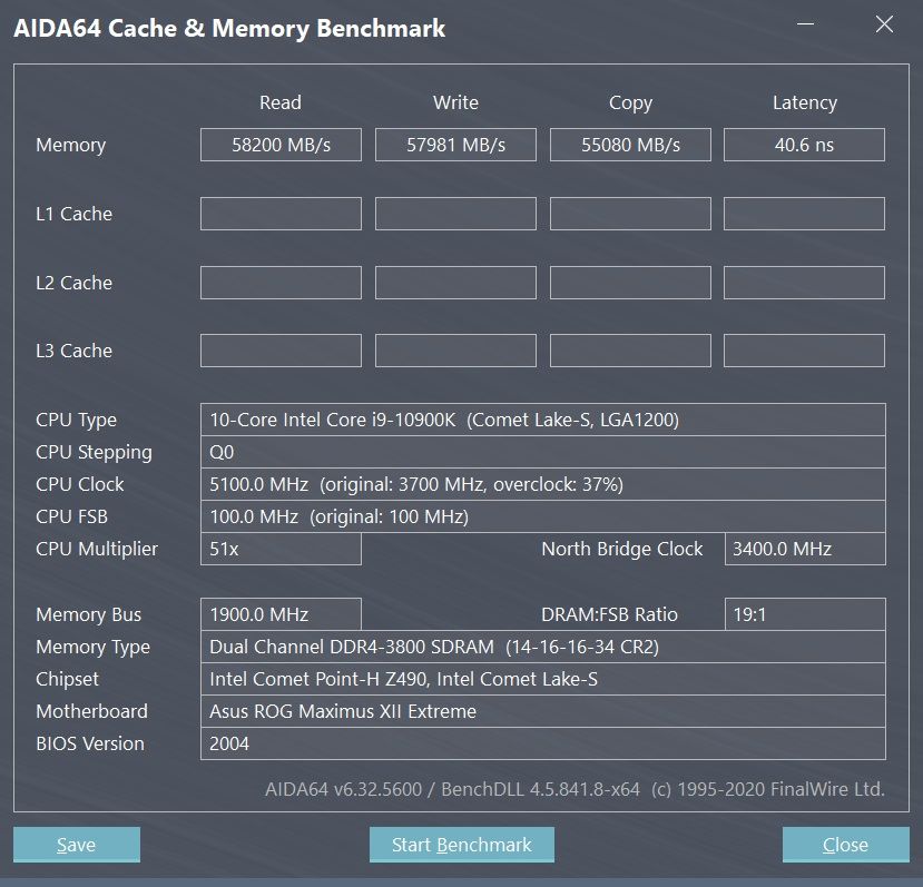

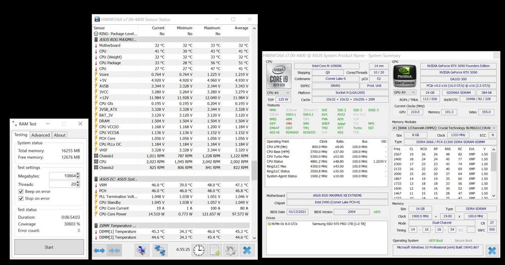

I just changed my BIOS micro code yesterday so I have been adjusting all my memory profiles, working on a 24/7 3800MHz profile now, it's not finished yet only running safe to tight timings but I will start changing timings to extreme settings today and bring Bandwidth MB/s up and Latency ns down a bit.
88041
I use Karhu, Prime95 to test stability.
88042
Good luck, have fun.
