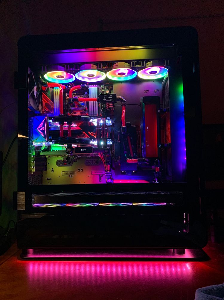

RGB for the most part is RGB. More will work than do not. You just have to make sure that they are not like Corsair and have propreitarty connectors. Truth be known you could get the Corsair fans to work if you could figure out which pin does what, cut the ends off and install different ends but thats too much trouble when you and just but their controller which quite frankly blows aura out of the water. Then consider 5V addressable vs 12V non addressable.
For my fans the RGB is done with lighting nodes from ccorsair each node has 2 channels, each channel can do 6 fans or sections of strips. The biggest PITA is making sure you get them in the correct order. Tha fans themselves are all PWM in 3 channels and PWM D5 pumps on a 4th channel all being controlled by an aquaero controller becuase Ive found nothing else that will work like it does. Tight curves and flawless........dayum, sounds like a a date!! LOL RGB is off the chain now. Went from non existent to overly abundant is 0.25 seconds. First thing you have to think about is the fans purpose as in moving air. RGB is ancillary
“Two things are infinite: the universe and human stupidity, I'm not sure about the former” ~ Albert Einstein

The LL fans are Corsair not Lian Li.
Damn Justin, a person could be hypnotized by those lights
