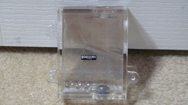

I have tried to build my loop with easy drain and fill in mind. My drain port works well but my fill port is just a waste of time. I think it gets a airlock and then the water just will not go down the pipe. I don't use dye bombs because I think they just stain everything. Water cooling parts are very expensive here in SA and very hard to get hold of. I have silver coils . I also use a few drops of some thing called dead water in my distilled water . Although it didn't stop something from growing in res. This week I pulled of one of my pipes to replace the barb with a compression fitting and noticed a white build up in the pipe. Distilled water is cheap so my thinking is to replaced it every few months.

xXx the white stuff is often the result of having mixed metals in your system. Ali and copper in a water loop are not the ideal. Wonder if you might have something like that going on?
If not then I am surprised that the kill coil did not do its work.

The white fluffy stuff seamed only to be around the edges of my res's narrow window. I flushed the system twice with premochill's sysprep. and put fresh distilled water in with a drop of dead water. I have also put my silver coil back in . My system only uses about 750 ml of water. I think from now on I will swop the water once a month because I have it down to a fine art now and it does not take very long.
