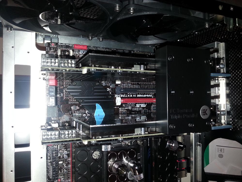

I'm starting to get somewhere with my build. I have just fitted my 2 x 7970 Matrix cards into slot 1 and 4 (to get both at 16x speed as recommended in the manual but...
I have an asus phoebus soundcard but the matrix in slot 4 is covering the PCIEx1 slot.
Can I put my soundcard into another full size PCIE slot?
The motherboard is a rampage 4 extreme.
Will this affect the speed of slots 1 and 4, will they drop to 8x
20639
Hope this picture helps. Not great quality.
20640
The 2 slots near the blue tape would be ideal.
Many thanks for anyones help 😛

If it fits under the EK bridge thingy you can put the sound card in slot 2B the black long slot with no drop for your Xfire but maybe you have a blank attached the other side of the FC link that would get in the way?
Though I don't see any screws? how is the empty slot on the FC link filled.....don't want to see a jet of water over your board!
CHA0SENG7NE
Hi Arne, Thanks for the quick reply.
It will fit in the black slot 2b. The fc link blank is only 3mm thick. I haven’t attached it yet, this is only a mock build, and Just to make sure everything fits correctly. It all has to be anodized black when im finished. The motherboard block fittings don’t have any acrylic tubing attaching them yet!.... working on it now though.
Do I have to change any settings in the bios to run a PCIEx1 card in a 16x speed slot?
Thanks

No, no BIOS settings have to be played with....just plug it in and off you go....I have that setup with my Xonar......I was even thinking of getting that link for the Titan water blocks and was wondering about the height/depth of the blank....so thanks for that!

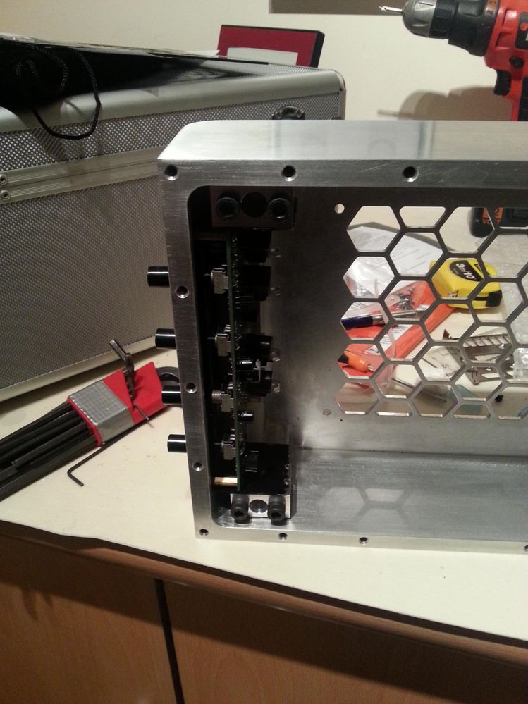

I am building in a Lian Li V2000b, finished machining my custom top for it to house the 420mm rad. Now its starting to get tricky....
Any thoughts appreciated

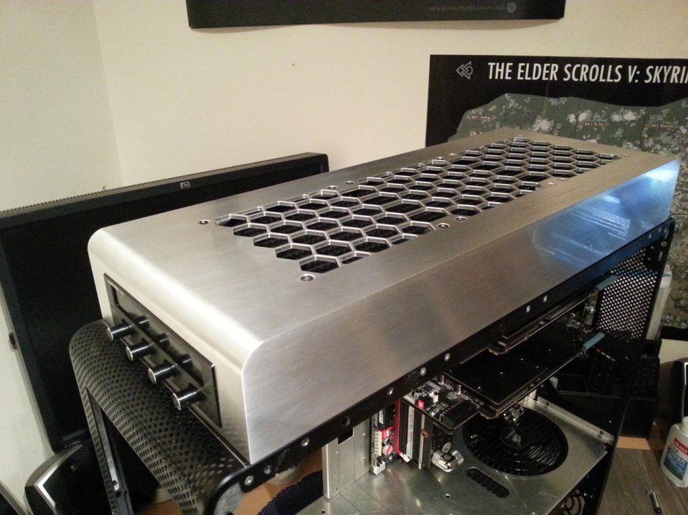

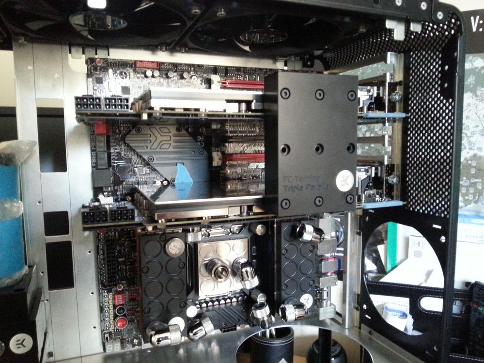

Well I managed to finish a little more on the motherboard loop, cut and fitted acrylic tubes last night.
The rad top has a front pocket cut to fit my fan controller. Held in place with two blocks bolted each side then fitted fan controller to these.
Here is some pics...20689
