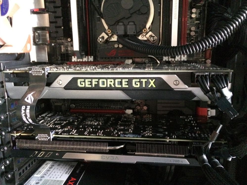

I installed today a second 780TI for make a SLI
I followed the instructions for the motherboard rampage iv
I put the second card in the other port pci_e 16x
I connected with the SLI bridge
37440
When I turn on the pc I hear fans of the card to the maximum. Then when windows appears he has turned a normal speed.
No mention of SLI in the NVIDIA Control Panel or in the device manager windows.
In the BIOS the card is not detected either.
37439
Is SLI bridge broken?

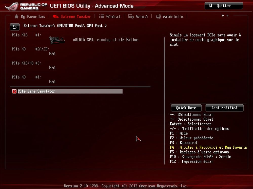

Pcie toggle switched to OFF 😮

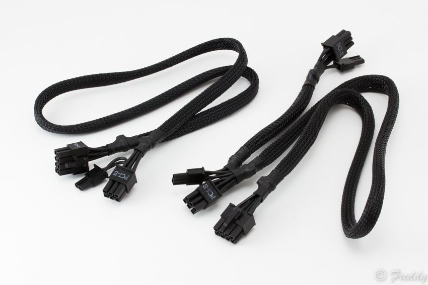

37443
Indeed my first card use 2 cables like the one at the left
and for the second card I used the right cable (Y cable but who have both 6 and 😎
Apparently it's not enough I had to use 2 cables the second card
so for 3 cards 6 cables? 😮
which PSU can offer so many places?
