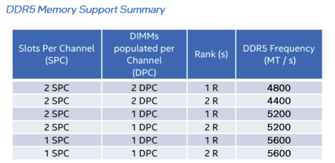

Anything beyond the below is considered an OC.

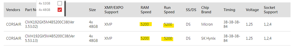

As an example, here is a Corsair Vengeance 192GB (4x48GB) kit, it's 5200MHz. Comparing the two memory kits, as you can see, more capacity will always = slower speed.
VENGEANCE® 192GB (4x48GB) DDR5 DRAM 5200MHz C38 Memory Kit — Black (corsair.com)

The table is very helpful now that I understand everything over 5600 is overclocking.  The 48x4 Corsair 5200 speed sound perfect for me.  I was just concerned that multiple forum posts on the internet have comments from people who couldn't get 4x48 or even 4x32 to work.  I guess that means they were going for much higher speeds.
I'm not building a gaming rig and I never overclock.  I didn't mention that because I get the inevitable "Then why are you buying this mobo/cpu/etc."  I just want to build a really high end computer, but a lot has changed in hardware since I built my last one.  I think I have my answer.  Thanks again.
Hi @wengang1
Understood. In that case, yes, the table should clarify what's considered to be overclocking. A lot of the posts you're referring to are likely users purchasing high-density kits and expecting 1. Either to be able to combine them and then run them overclocked 2. Expecting to always be able to achieve the kits validation frequency [either without manual tuning or at all]. Running the kit at stock should be no problem at all.
