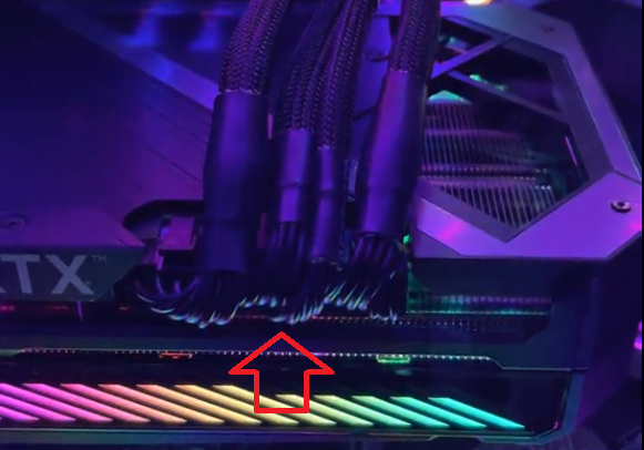

Here's a video (1 min) showing the issue:
https://drive.google.com/file/d/1k3Tk2c6ONNtCoNUTi8l-ShPgVzdZt6Kk/view?usp=sharing
Brought it into MicroCenter to get the PC diagnosed, they thought it was my cable extensions and well...those are gone and the problem is still there. I really can't figure out what's going on with this darn thing. I called Asus, they don't even care to look at the video. The problem is intermittent, only happens once every few days, so there's a high likelihood that Asus won't be able to reproduce the issue. Moreover, they won't simply replace the motherboard, they insist on repairing it, and well...if they can't reproduce it or look at the video to see what's going on, I'll probably just get sent back the same motherboard with no fixes.
I tested my PSU with the included testing tool (included with EVGA PSUs), and it seems to be working fine. Not sure what to do or what's causing this.

I'm using an EVGA SuperNova G3 1000w. And I'm not using a UPS, though I've never had any problems like this with any previous PCs. I'm inclined to think it's most likely the motherboard, or perhaps the PSU. I plan to RMA the motherboard, but Asus is only going to provide a refurb. Who knows if that will come with its own problems.
Is that an 8 pin (4x4) CPU Cable?
