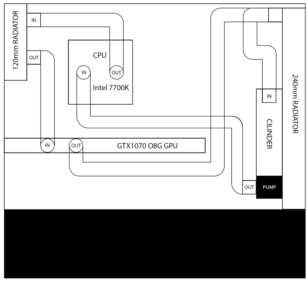

Hello, i want to build liquid PC cooling with flexible pipes and can't decide if 300L DDC-3000rpm pump is enough or need more, please see this example photo.
Thank you for any advice.

I've used a single DDC with two blocks and two rads and it seemed to work fine. I even had some quick disconnects in the mix IIRC. Personally I prefer D5's if you have the space. To me they sound better than a whiny DDC.

Hi, what specs have your pump?
Thank you.
P.s. from what i see this build in my head i understand the faster water will flow the better it will cool so i think need more than 300L for such loop.

Most DDC pumps are similar in terms of performance. There have been revisions over the years which help with reliability and some are straight voltage vs PWM. My DDC pumps are very old so you likely won't find the exact same one.

i have used both of them and prefer D5
but if you buy D5 dont run it at max speed setting, it will only heat up the water in the loop and radiators have to work just to keep the water temp down
i did an experiment before, because i suspected the above
i connected a short loop: pump-tubing-reservoir (no radiator or blocks), and had the water cycle for 10-20 min with the D5 at max speed setting
after 10-20 minutes i grabbed the tubing and it was so hot that the tubing almost collapsed, very hot
sorry this was off topic, but i don't think there is so much information about this in here, so it can be worth to mention
I believe there are a couple of different versions of the D5 PWM pump on the market today, some said to be better than others (longevity)
so you might want to look on into that
D5 have my vote, i had many before without any of them failing on me
DDC = good for small spaces
D5 @ 100% speed setting is not improving the loops cooling performance!
(pump speed setting 2-3 or 20%-50% is normal and its really no benefits running the pump faster than this under normal scenarios)
noise proof the pump, with thick silicone feet under (it easy to DIY), and it will be very quiet once the air is gone from the loop
the pump make annoying noise if its attached directly to the case or running at very high speed
good luck

DDCs are louder and need heatsinks. They have a better lift at the sacrifice of flow rates. Ive used both and prefer D5, preferably at least 2 in serial for more flow and redundancy.

Because of limited space i decided to order DDC PWM 800L pump from Freezemod without load have 5000rpm but with load is 3000rpm speed, also based on reviews everyone say that it is very quiet.
Will post updates on how it goes, thank you everyone for support.
