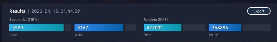

Now i'm booting off of the SSD, and I wanted to test thermals since it sits right above my 1080 Strix (And not much airflow gets past that thing since i have bottom fed fans.)
Here are my Test results. The temperature fluctuated between 65 and 67 degrees. Honestly, to me that's pretty warm. And this is using Samsung's Magician tool, not a gaming benchmark test. If it got that hot on this test, i'd be worried about gaming on it.
84610
After that test, I took the GPU off again and installed the 970 into the bottom slot (M.2_1?*) That shares a SATA port with #1. I moved the SATA #1 (My old 860) and left it empty. I left the sticker on the 970 on, and installed the heat shield with the thermal pad.
This second test, I only hit 38 degrees. And here are my results.
84611
Looks like the bottom m.2 slot is MUCH better than the top. It's only sharing the 1 Sata slot.
