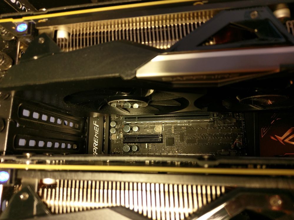

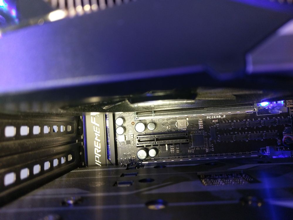

I am wondering if a very "low profile" PCIe 3.0x16 extender flexible cable exists. I cannot find one. I see flexible ones, and I see angled ones, but they all seem to be at least 3/4" tall from the motherboard socket.
I have a PCIe 3.0 card with an extra M.2 Samsung 250G NVME PCIe drive on it, and wanted to put it in my rig, but with two dbl-slot GPU's (Crossfire) they block the correct slots to use. Actually the bottom of the cards are almost exactly at the female connections of the next & correct slot (so a mm or two greater than the slot height). I think I could use a flexible cable extender to sneak behind one of the cards and move the M.2 card in the rig, but the GPU's fit down so close to the motherboard that I think I need a very low profile extender cable to sneak behind it. Thus the question.

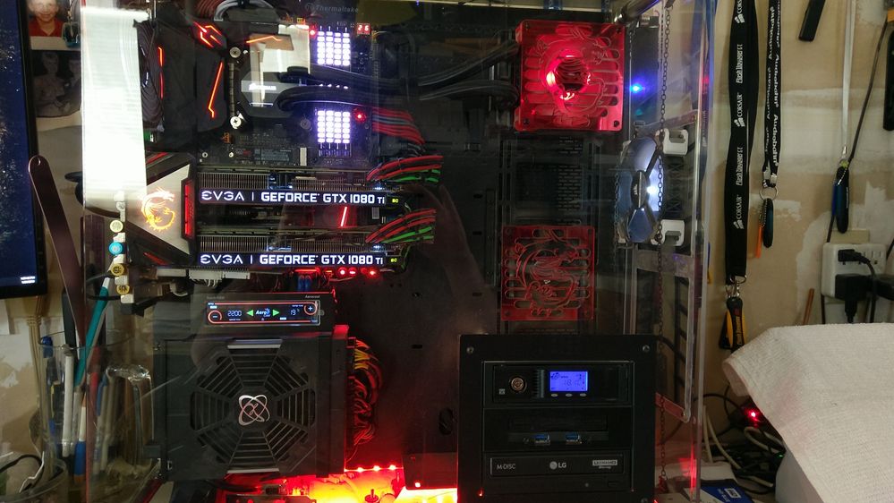

I have a set of two like these for my GTX 1080Ti video cards. They work perfect. the only thing I needed to do was buy some 6x32 stand off to make up the height, between the case mount and the video cards. But worked perfect. Make sure when you do the standoffs extensions, you do both posts. That would be a total of four, "two for each video card, if you need to do two??.
I needed it so I could install a ribbon cable underneath one of the GTX 1080Ti cards for a TV card.....

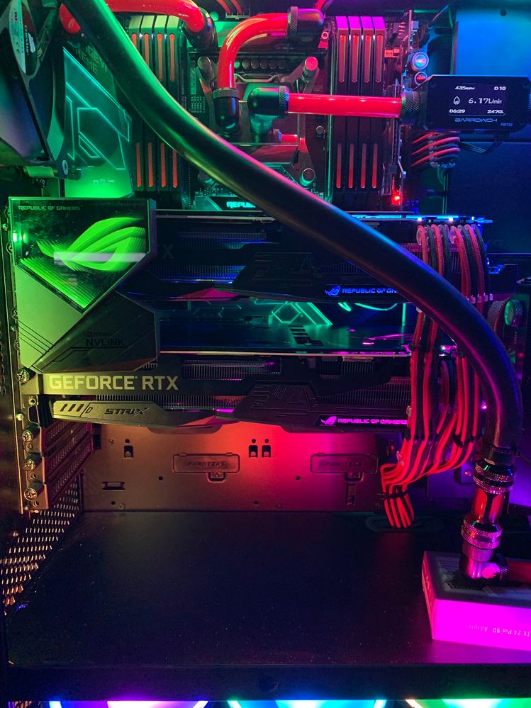

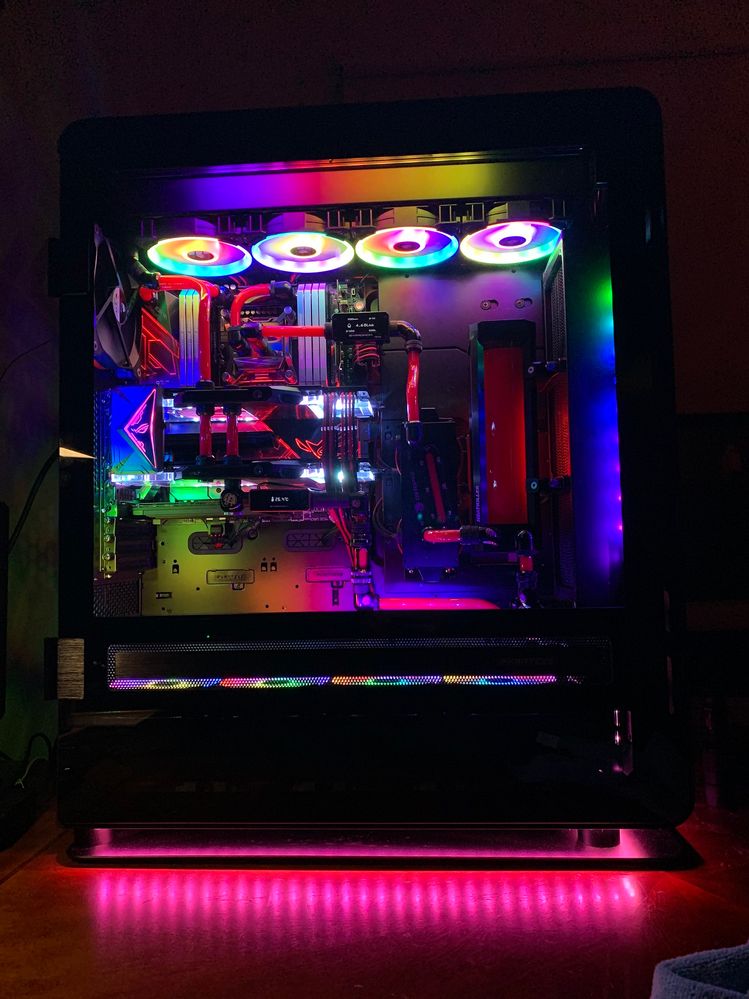

You think you have it bad.........Look at the enormous heatsinks on these monsters!! Cant fit a greased BB in there!! Had to move my OS to DIMM.2 960 pro and yank my optane drives. Dont mind the ugly PTFE tubing. Its a temp bypass for the GPU blocks, pulled my 1080Tis with EK blocks and took some time to find blocks for the Strix 2080Ti O11G cards. They will be in tomorrow and Ill be back to having my other 2 slots. The call these 2.7 slot sinks........Why not just tell it like it is, they take up 3 slots!! In case anyone was wondering......Dont try this long term on air unless you have a case that blows air in between the cards. The top card is starving for air and runs 10C hotter than the bottom card. A nice long Timspy stress test with the case door open and the back plate was too hot to touch. Im dogging the crap out of them on air before i pull the heatsinks and put water blocks on and can go back to normal like second pic.

....The call these 2.7 slot sinks........Why not just tell it like it is, they take up 3 slots!! In case anyone was wondering......Dont try this long term on air unless you have a case that blows air in between the cards. The top card is starving for air and runs 10C hotter than the bottom card. A nice long Timspy stress test with the case door open and the back plate was too hot to touch....
Yep, this seems to be a common problem these days and it'd be really nice if manufacturers of motherboards/cases caught up with and addressed component configuration problems integrally with their designs. Why should all these third party aftermarket products be needed just because you can't use ANY of the other slots on the board after installing 2 GPU's, or at least reasonably and easily use them. Isn't that why you buy an EATX FF and a big honkin' case? Like you say, if I install something in between the two cards, heat still rises in the year 2019, and blocking the air path between the cards due to space constraints just causes other performance issues. Seems stupid to me given how many years we've had "2-slot" or more GPU's (read 2-slot as 2.+ slot, because IT AINT two).
How about case manufacturers sell high quality riser standoffs and extended or telescoping card brackets as options with their cases? Or even simply just longer bracket screws for a standard sized riser standoff that they offer? So easy to do. Or motherboard slot spacing standards adjust to account for the product market? I do understand the design and manufacturing cycle is long however so this may be a challenge. The problem is mostly with GPU's and nowadays high end boards that are used for this don't need specific spacing for SLI/XFire brackets because it's handled internally to the boards.
The problem that exists here in this thread should not exist in 2019 IMO.

Justin Thyme: That is an awesome computer....:cool:
