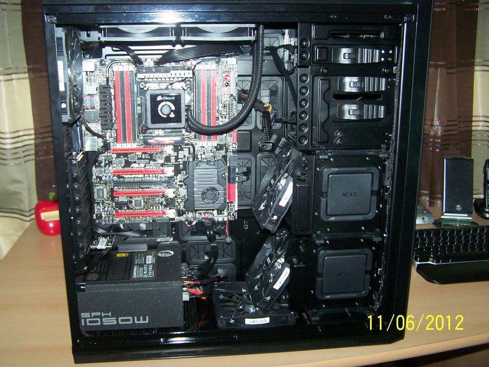

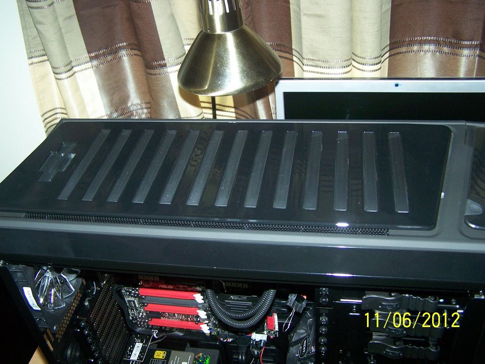

I can see how that can be a little confusing, this is what I meant :
Here it is with the top cover on.
9208
Here you can see the 3 x 140mm NZXT red LED fans when the top cover is removed.
9206
And here you see the H-100 mounted inside with the original 2 x 120mm fans installed.
9207
And this is the build so far, I'm a little busy these days. 🙂
9209
So you see that I have the 2 x 120mm pushing and 2 of the 3 x 140mm pulling.
I have 9 of the NZXT 140mm red LED fans installed in total plus the 2 on the H-100 for a total of 11 fans.
As you can see, the Switch 810 case makes using 120mm and 140mm fans together in push/pull configuration easy. First I installed the 2 x 120mm fans onto the radiator, then I mounted the rad to the case with all 8 x 120mm mounting holes aligning perfectly with the top plate of the case.
Next I installed the 3 x 140 mm NZXT fans from the top, if you look closely you can see that the 140mm fans are screwed in from below in the H-100 Picture.
